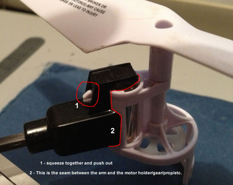

    Basic Syma X1 disassembly:

    7. The entire end assembly comes off of the arms by pressing together the small nub which comes through the arm and then pushing and working the end (landing gear complete with motor) off. It is much more evident how this is done when looking at the WHITE ends, because the black all blends together!
