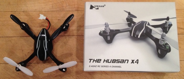

    Having lost my last X4 in a small evergreen tree, I decided that I cannot be without one of these in my stable, so I purchased the "bare" X4 H107L which is available without the TX or battery. Unlike the full X4 kit, this comes in a very small box and includes nothing except for the quacopter.
    (Hubsan Quads X4 H107L as sold by this Amazon Link)
    The price was about $34 including shipping.

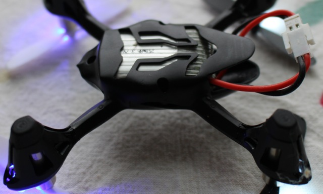

    (X4 with LED's - notice the chewed up props after some nice crashes!)

    1. The propellers have been redesigned so that they completely cover the exposed motor shafts - this allows them to protect the shafts on upside down landings (crashes). Earlier models needed the "straw" modification to help with the problem of premature motor destruction.
    2. The feet or landing pods are now made of a softer rubber-like material which allows more shock resistance on hard landings or crashes.
    3. The bottom panel of the quad - the part which receives and holds the battery - has been upgraded with a softer material, allowing easier placement of the battery. This also helps with shock resistance as the same panel extends out all four legs and is part of the "break apart" design of the legs. In a bad crash, the bottom of the legs will separate slightly from the top....and can be pressed back into place easily by hand.
    4, LED's have been added at the end of each of the quads arms.

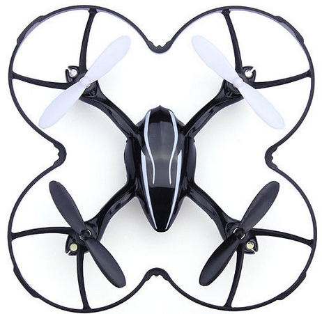

    5. An optional propeller guard is sold which is ideal for inside use and beginners.

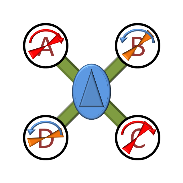

    My x4 Hubsan Quads side the wind is doing wrong as I do it back to normal, white propeller wind is up and the other side black part does wind down and now?
    Is your X4 able to fly? Or, do you think you have the propellers installed wrong?
    This is the propeller setup for most X quadcopters - the higher surface of the propellers should be moving in the same direction as the arrows. When a propeller does this, it pushed air down, which makes the quadcopter rise up.
