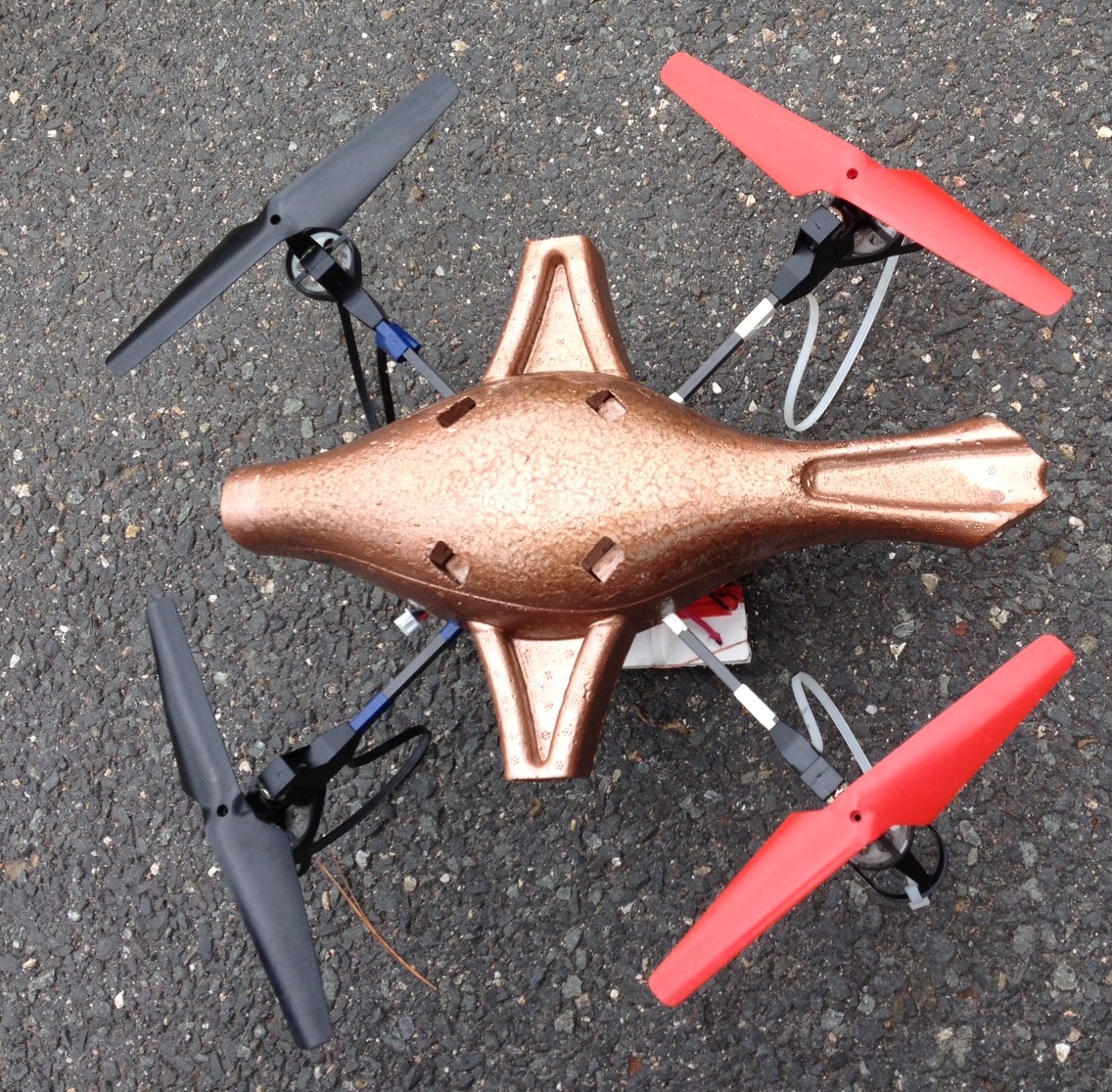

  5. webman

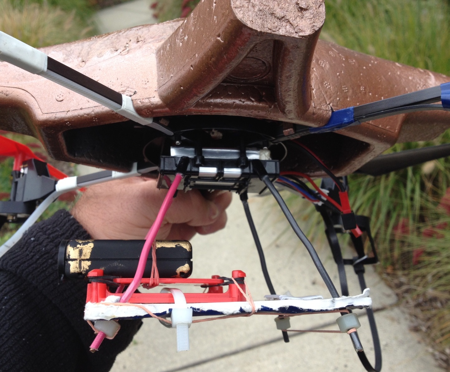

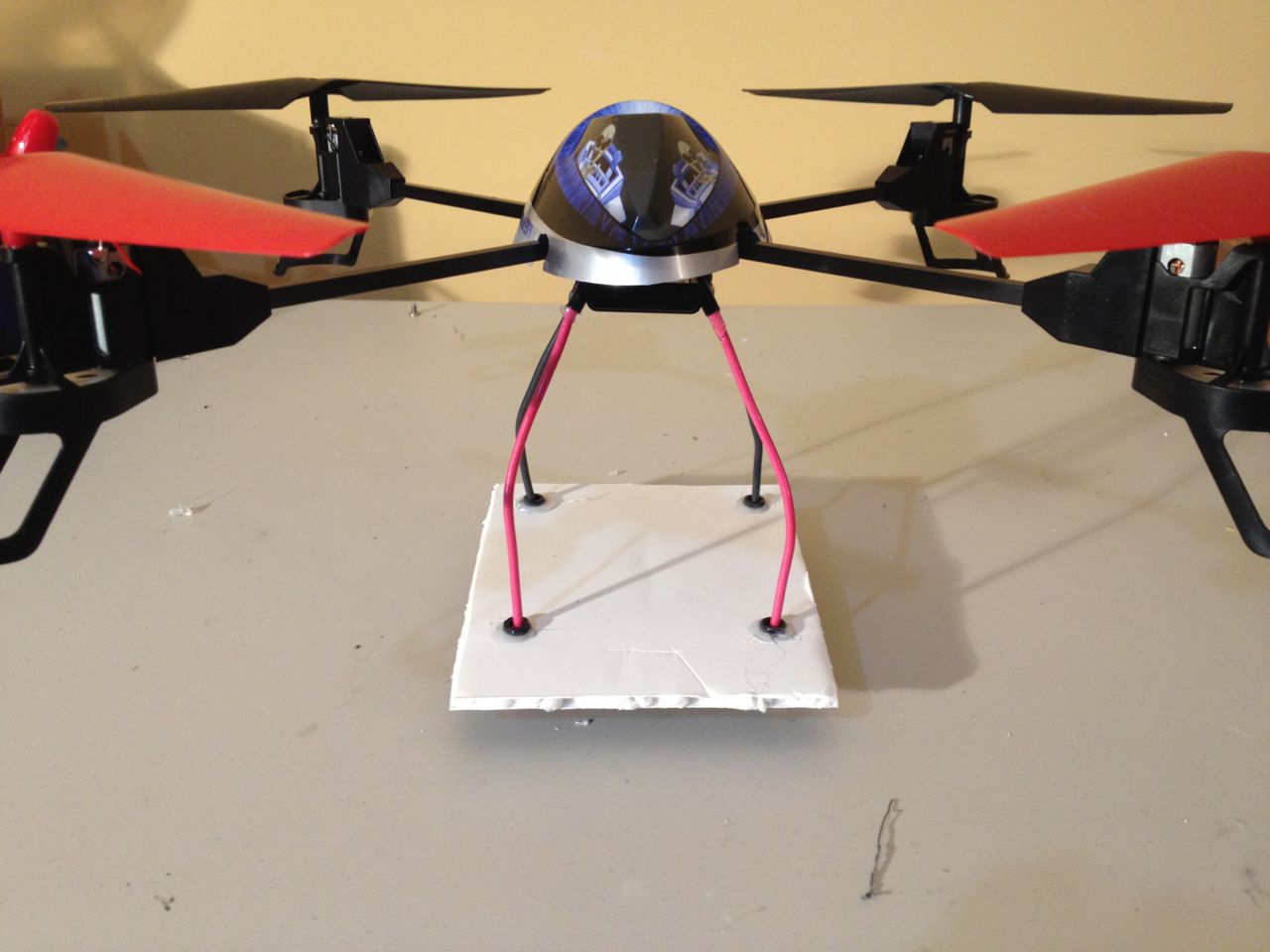

    Here is my 262 setup - I tend to outfit these instantly off the shop floor (junk sitting around) as opposed to thinking then through - because I want to fly ASAP.
    I cut down the foam shell and removed the decal (weight).
    I put some zip tie landing gear on - but I should have used heavier zips - or done away with it, since it lands fine on the copper wires. Or, I could have used longer wires and bent them sideways to provide a landing platform..
    The wires are fairly heavy - I think #10. I removed the landing skids and glued them into the holes - they have held in there fine. Then I just grabbed a scrap of foam board for the cam platform. Those white things at the bottom are little nylon nuts that thread onto the wire insulation and hold fairly well - and allow adjustment. The Mobius holder is not needed - that is a Range Video made mount which may reduce vibration, but I don't think it works in this application.
    Other than that, we are talking rubber bands, etc!
    The gold paint on the Mobius may help find it if it falls off in a crash. Those of you who really want to make sure should attach some small folded up streamers (red, etc.) to the bottom of it, so they deploy when the cam ejects. I've had two cam ejections (one with another copter and one with this) and a black cam is tough to find in the grass and weeds.

    Thanks for the pictures of your setup.
    I have had one ejection with my setup with that earplug contraption (posted previously) following a crash landing. I have since decided to do away with the earplugs. With future setups between the quad and the keychain videocamera I will connect the two with a short piece of mono filament fishing line.

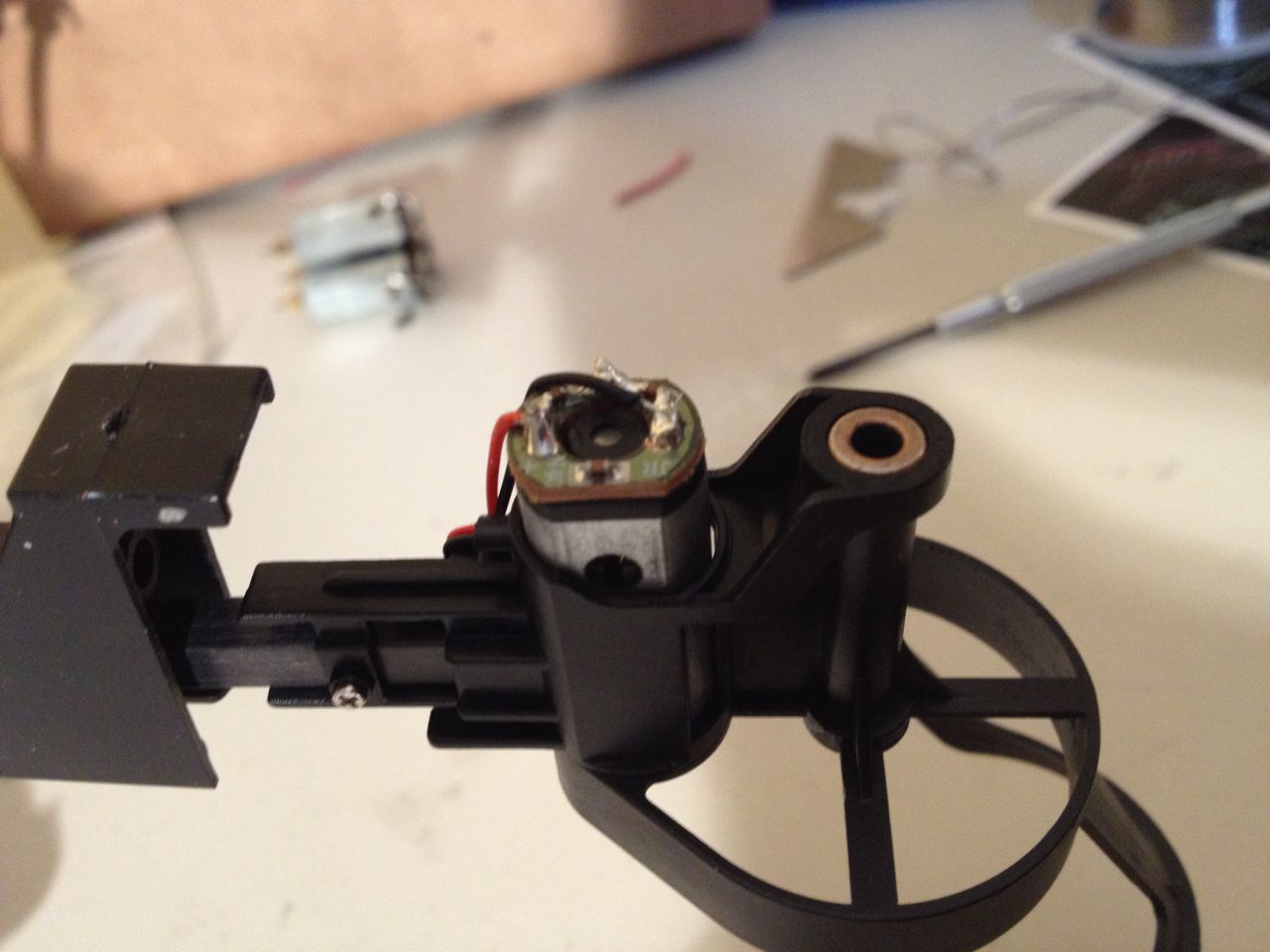

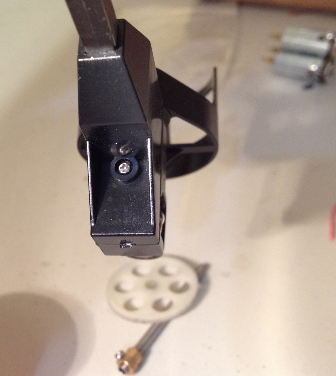

    Replacing Propellers, Gears and Motors on the WL Toys v262
    Prepare by having the parts available. MassiveRC is one US vendor who does quick ship and has most parts. Replacement of the props and gears requires no soldering - replacement of the bare motors requires basic soldering skills. However, there is a workaround - ask MassiveRC to sell you the entire boom assembly or motors with connectors already attached.
    Here are some pics and a short description of replacing the major drive parts on the WL Toys v262. The plastic gears and motors WILL wear, so keep an eye on the gears and on how your copter flies for hints of their failing.
    Click pics for enlargements

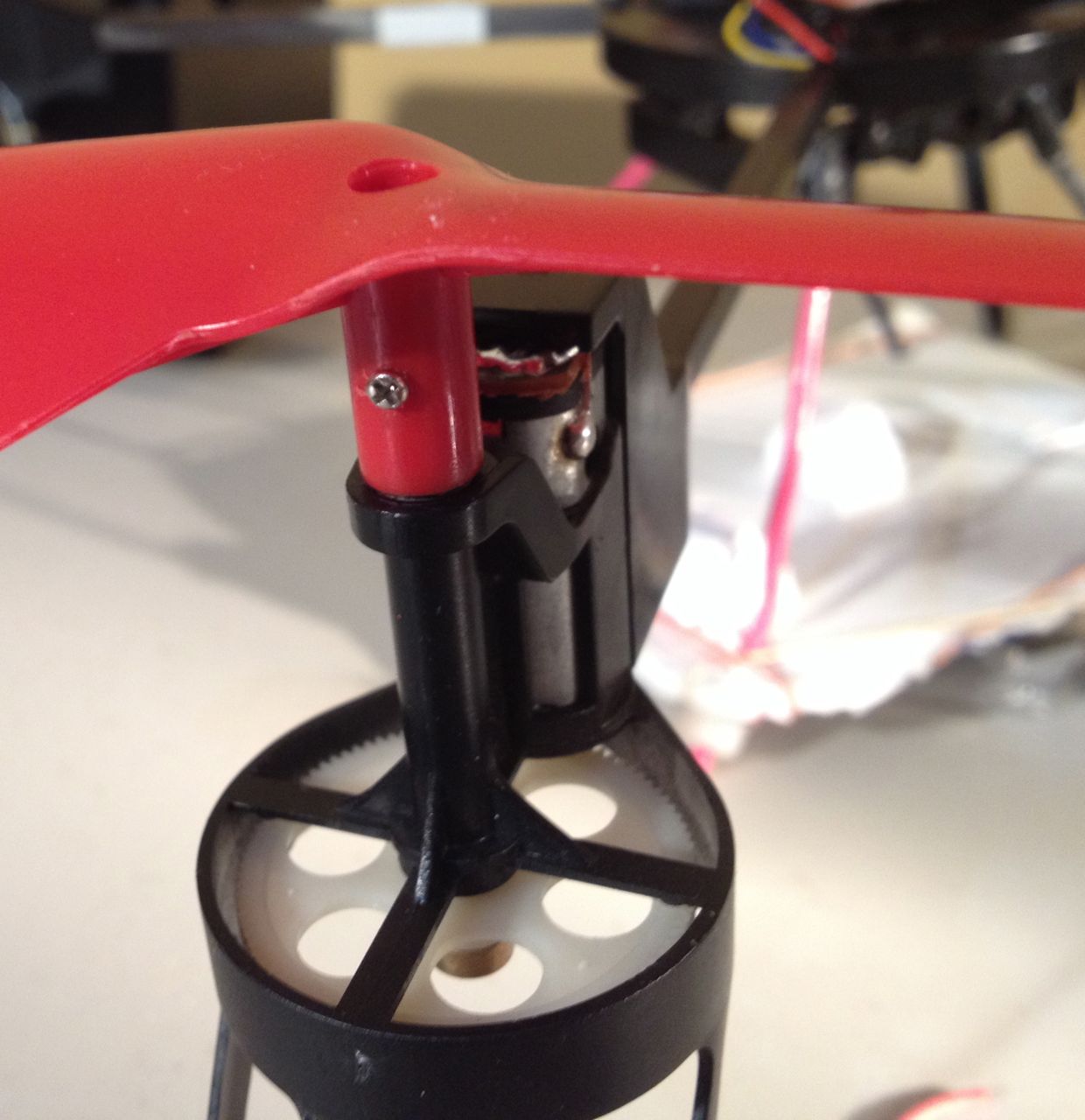

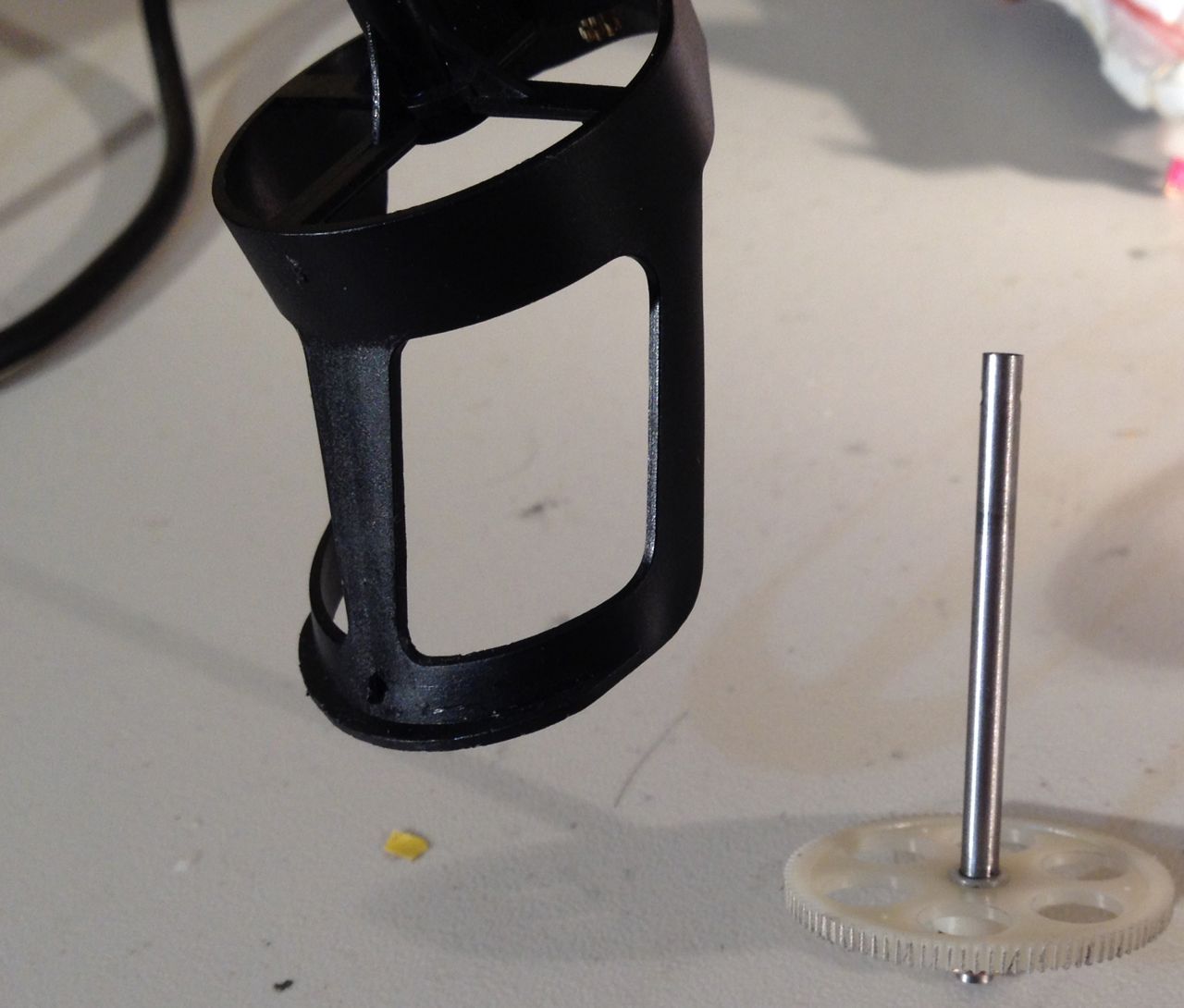

    1. Remove Propeller by backing the prop screw almost all the way out - or removing totally. Be sure to have a bottle cap or other small receptacle to keep the tiny screws in. Slide prop off upwards.

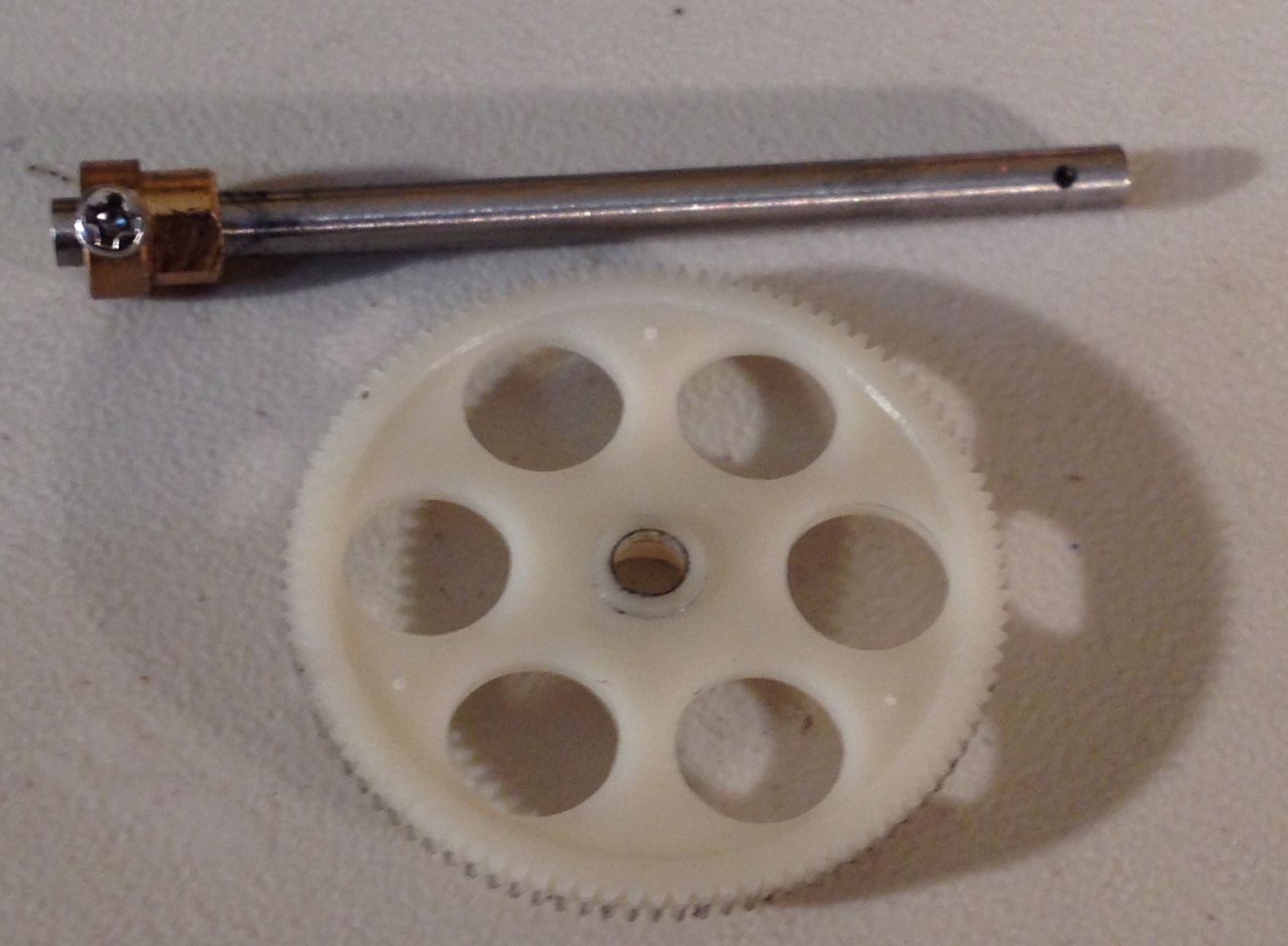

    2. Push down on prop shaft or gear and the shaft along with the gear can be removed from the bottom. If either of the brass bearings (one top-one bottom) fall out, you can press them back into their plastic recess.
    3. If you are replacing the large gear, slip it off toward the long part of the shaft - then simply replace it with the new one. Reassemble the copter if you are not replacing the motors.....continue if you are!

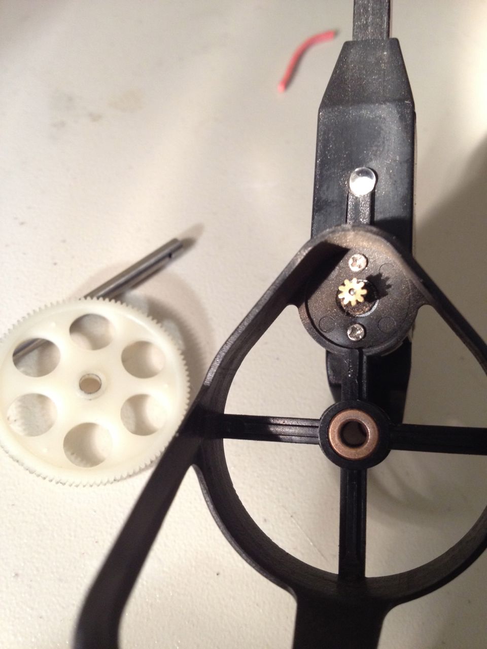

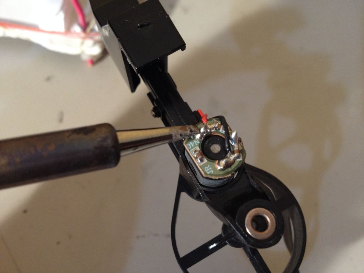

    4. With the v262 upside down, remove the two tiny screws on each side of the motor gear - these hold the motors in place from below.
    5. The motor cover (boom end cover made of plastic) must now be slid back. Remove the single screw shown in the picture below and slide the cover back. This screw is facing the main board - so you'll see it by looking from the center out.
    6. Slide the Motor cover back on the boom toward the center to expose the motor top.

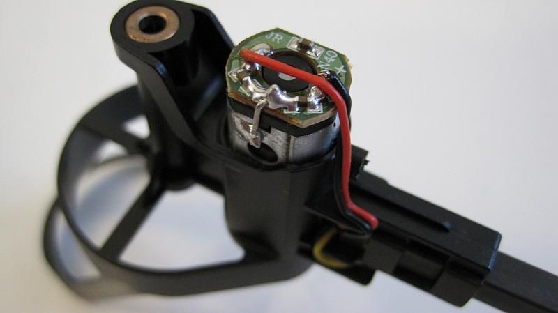

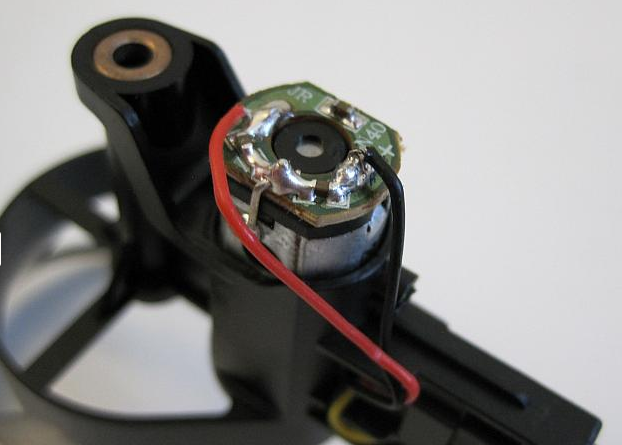

    7. As of this writing, there are not two different (clockwise, counterclockwise) motors - they are the same part! The difference is that the wires are reversed when soldered on. This makes replacement easy - just note which way the motor is already wired and replace it the same way. Desolder the motor leads, slide the new motor in and attach as it was before. Reassemble the copter in the same way you took it apart, taking care to properly route the little motor wires so as not to break them.

    3) The positive and negative motor wires should not be routed near each other where they are close to the motor. The stock wiring looks like this:
    This image has been resized. Click this bar to view the full image. The original image is sized 800x449.
    You want them routed far away from each other and especially route the positive lead at least 1mm away from the motor can:
    If you follow the default motor insertion scheme that WL Toys uses, CCW spinning motors/props have the red lead towards the outside, soldered to the negative terminal of the motor, which is also outside.
    The CW spinning motors/props have the black lead and negative motor terminal towards the outside.
    This way you can tell at a glance which booms are CW and which booms are CCW simply by looking at which colored lead is outside (when wires are ran the way I do them above).

    I liked the former setup for holding small cams, so I duplicated it and did a slightly better job by using some hot glue and plastic washers to reinforce where the wires go through. Here's a pic. The wires also serve as the landing gear - I put a bunch of hot glue on the bottom of the wire ends after folding them over. It's easy to adjust the angle just by bending or with rubber bands, etc.

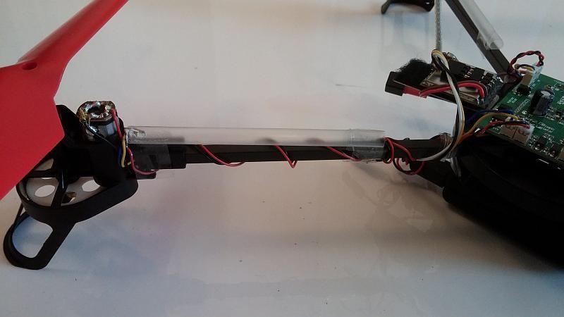

    For those of you replacing your motors. If you care more about convenience than looks you can wrap the motor wires around the boom or through the straw of your light saber mod instead of trying to fish it back through the boom. If you pre-solder up some motors to take with you, you can easily replace a motor in the field without having to go back home to repair. We ordered some extra motor leads with the intent of offering pre-soldered motor leads as a cheaper alternative to the boom assemblies (if you all are interested):
    You could do the same with the LED wires but usually those don't go bad in a crash.
