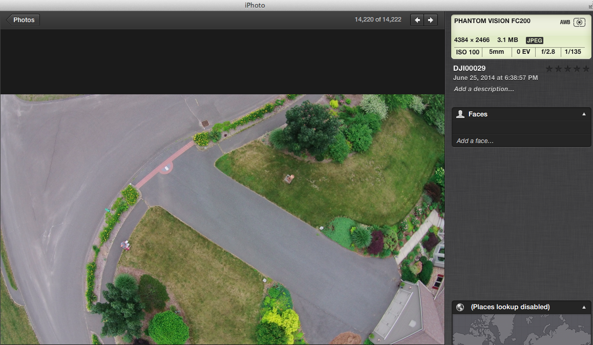

    2. While you can pull still shots (frame grabs) from any video, the quality and resolution is less than of the still shots. HD video is about 2 megapixels while both the GoPro or the vision+ are capable of taking stills with 5X that resolution.
    I'd say that, for most applications, the quality is quite similar.
    The tradeoff, IMHO, is that the GoPro is probably more shockproof - you don't want to crash the Vision+ cam. Then again, even a GoPro gimbal will probably be ruined in a crash.
    The downside of the GoPro is that you have to do all the integration as far as FPV and control of the camera. The Vision allows you to easily switch from video to still while in the air - not sure if the GoPro can easily do that.
    Here is a screen shot showing the photo info on right of the Vision+ still camera:
