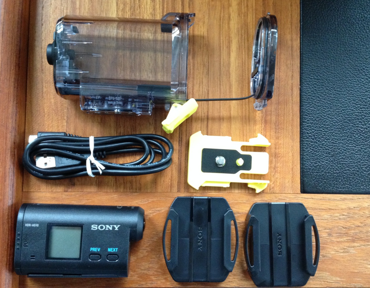

    The recent bargain came with everything needed except the MicroSD card. Shown below is what is in the kit. You will have a tough time finding brand name action cams with the full shock and waterproof housing at this price level. Whether all those features do you any good - that may depend on what type of machine and conditions you intend to fly it in!

    Considering the battery size, a basic LCD control display, etc. the size is relatively small. The height is about 1 7/8", the width 7/8" and the depth, including the lens, is about 3 1/8". However, as many other reviews have remarked, the camera itself has no mountings, so if you want to use the camera bare (without the water and shock-proof case), you will have to devise your own mounting. I wanted to fly the camera light, so I rigged up something in a minute or two with soft foam inside a bigger case.
    Camera with battery = 86 grams
    Case complete = 86 grams
    Removable mount (2 pcs) for case = 28 grams
    As you can see, the camera itself is relatively light - but if you want to fly the whole setup you are approaching the payload of a mid-sized quadcopter like the standard DJI Phantom. Only quads of that size and larger should be considered if you are going to fly this camera.

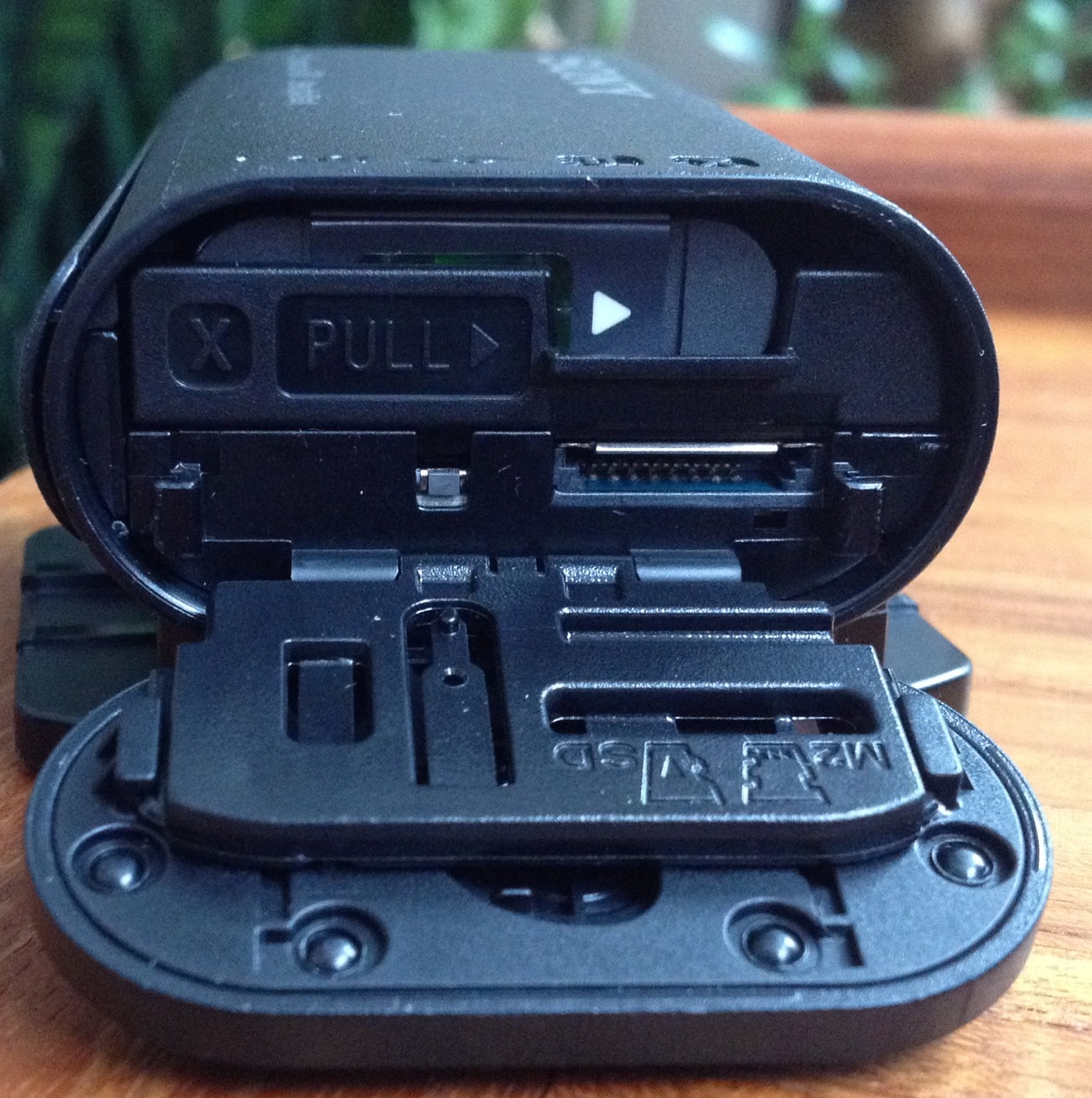

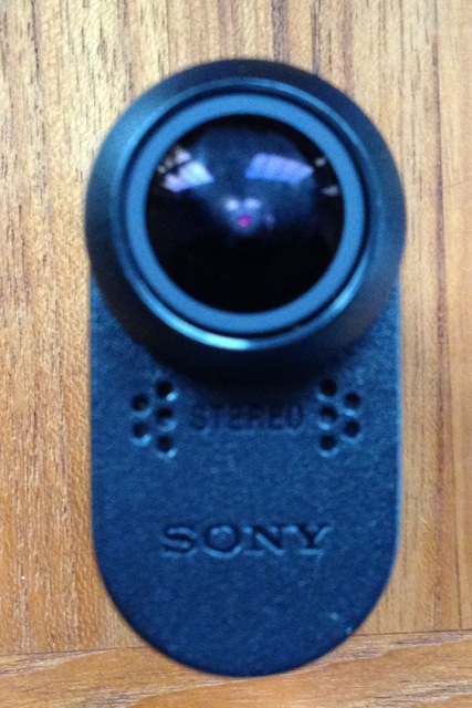

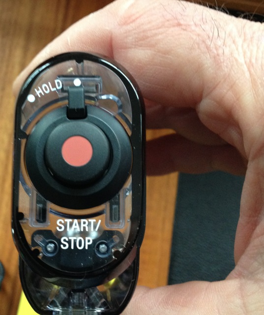

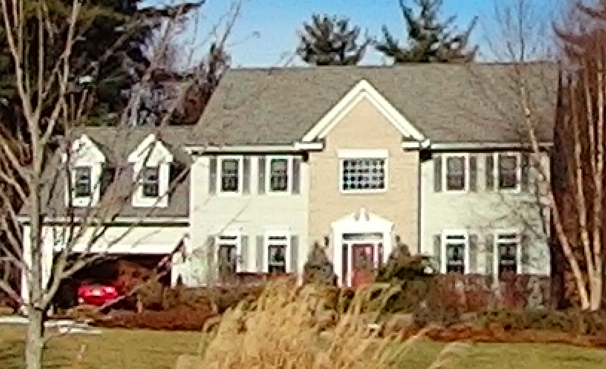

    This is a enlarged section of a photo taken by the Sony (click to enlarge if need be). Although some of the patterns seem pleasing, the jaggies on the front gable are quite a bit larger than with the Mobius (see photo below). This is largely due to the higher res stills which the Mobius takes.

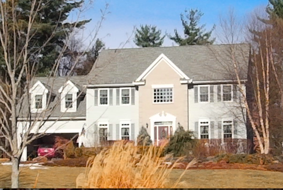

    Photo below is the Mobius of same house
    Each of us has different eyes and CPU's (brains), so not everyone is likely to agree on which camera is closer to real life.

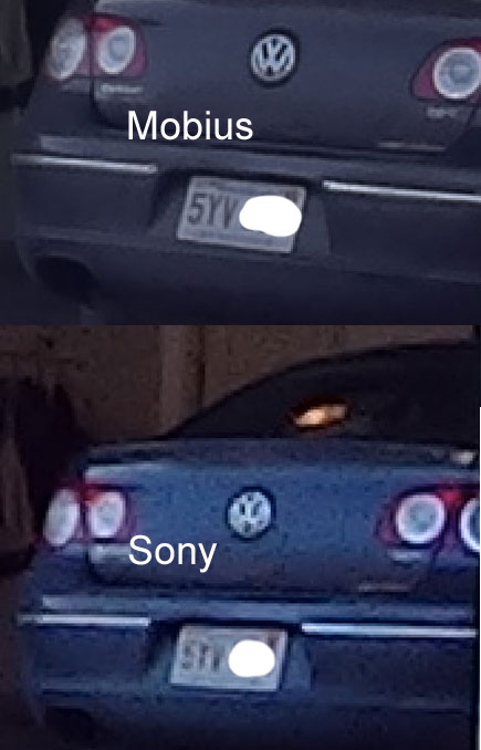

    As far as clarity and resolution, I think the Mobius wins hand-down as is evident by the below test - both cams were held together and took still shots. With the Sony, you'd be unable to make out the numbers on the plate - not so with the Mobius.
    I'm afraid I must declare the $80 Mobius far superior for still shots!
