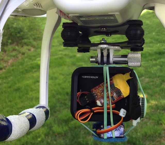

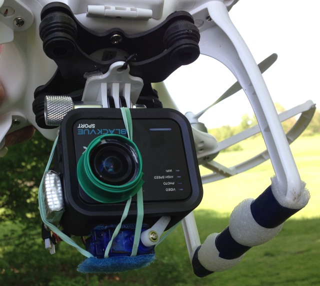

    After setting the timing and testing the basics, I rigged the servo up to the BlackVue rubberized case. I used a simple method of velcro and rubber bands. Since this camera is a fixed focus sports model, I don't need to use the two steps (focus, then press), however I left it programmed that way and positioned it so that the final movement pressed the shutter. The bench test seemed to work, so I'll cut some of the wires and use some solder and heat shrink to make for cleaner and more reliable connections.
    A few minutes later, I had a simple rig which was ready to be bolted to the Phantom- here's the setup - I have longer legs for the Phantom on the way - although I use "catch and release" for most of my camera launches and retrievals. Now it's time to give it a try!
    Note: Total weight of camera (w/o rear LCD), holder, servo, battery, timer, etc. is 140 grams.
