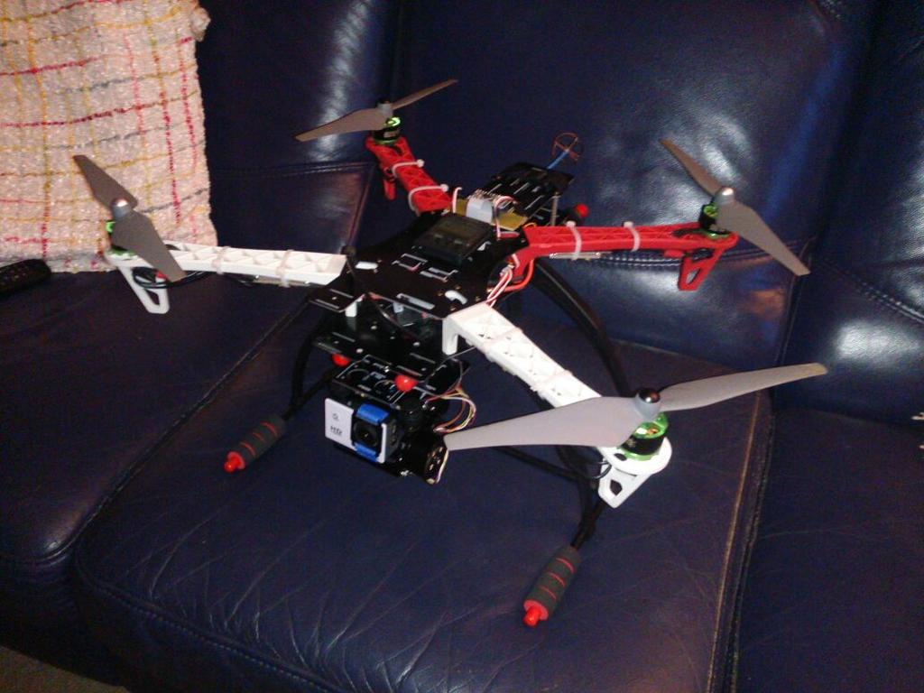

    Hello people,
    I'm having a problem with my new frame. It is flying perfectly without gimbal, I calculated the setting for the motor channels.
    When it was flying stable I wanted to add the gimbal. Then tried to fly it again, but was VERY unstable. The quadcopter is balanced with the gimbal on the front and accu on the back. Even when gimbal is not powered, its unstable so no emc or something i think.
    Have no idea what to do now, any tips?
    When you say 'VERY unstable' are you talking about oscillations similar to this?
  3. PwsuxDNL
    PwsuxDNL New Member
    Hello RGJameson, thnx for the reply, I got the oscillation fixed now.
    But there still is a problem with the yaw and throttle not responding properly (Only when the gimbal is mounted on the frame).
    Pitch en roll seem to be ok. I am using a KK2.1.5
