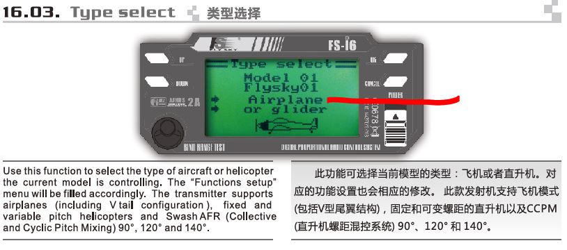

    That really shouldn't matter. Let say you want a level hover, the FC (CC3D) is supposed to compensate, spinning the appropriate motors either faster or slower. It doesn't care about the absolute speed that you mentioned as it should be constantly changing the RPMs to maintain level in this case. Something else is causing it to flip, you need to carefully review/re-do your set up. Calibrate it again on a level surface. Are all the motors starting at the same time?
    Are you sure about the props?
    Make sure you have Airplane as your model with your i6.
