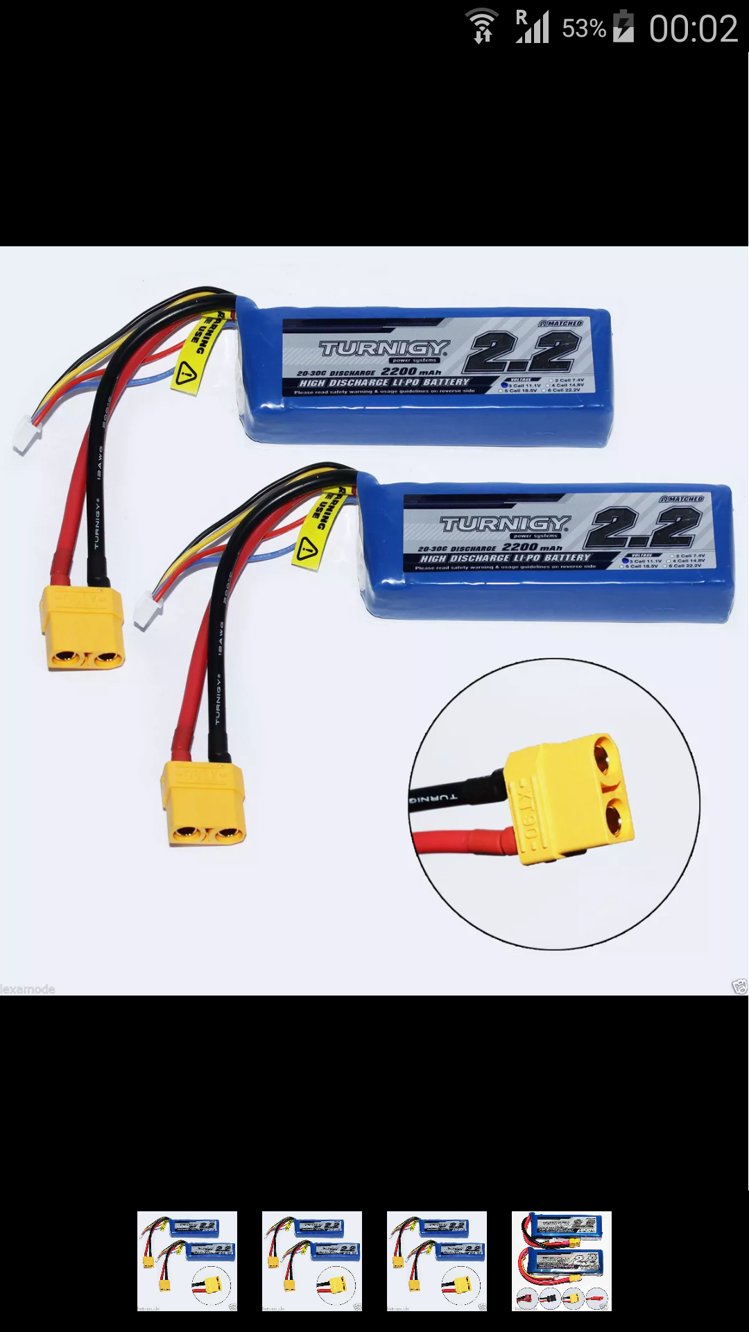

    Wonder if any of you would be able to help me. I ordered a Turnigy 2.2 3cell 11.1v battery. Its a XT90 connector. Thats where I made the mistake. I should have ordered the XT60. Would I be able to just cut the connector and change it to XT60?
    Sure why not. One tip get a mated set and when you do your soldering have them connected. It will ensure a better fit as the plastic can distort a bit if you only solder the battery end making for some difficulty when plugging into the quad end.

    Thanks RG. I haven't a clue what you mean by mated set (new to all this), but I will youtube the life out of it!
  4. RGJameson
    The male and the female.
    Plug them together before soldering.[​IMG]
