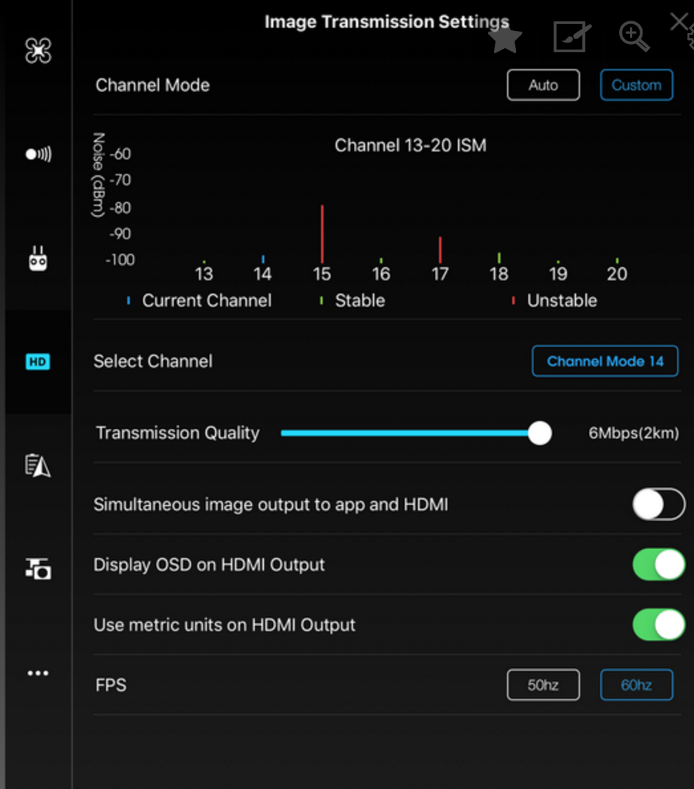

    I think the signal strength does show something - BUT, the best trial and error is to enter the HD part of the Go App (the r/c part) and choose a "custom channel" - somewhere from 18 to 20. Also, turn the mpbs down to 4 (or as low as they can go)...

    I fear that camera (app) disconnects are just part of the P3 - my P4 doesn't seem to do it (yet), but I hear a lot of reports with the P3. Yes, custom channels will help.
