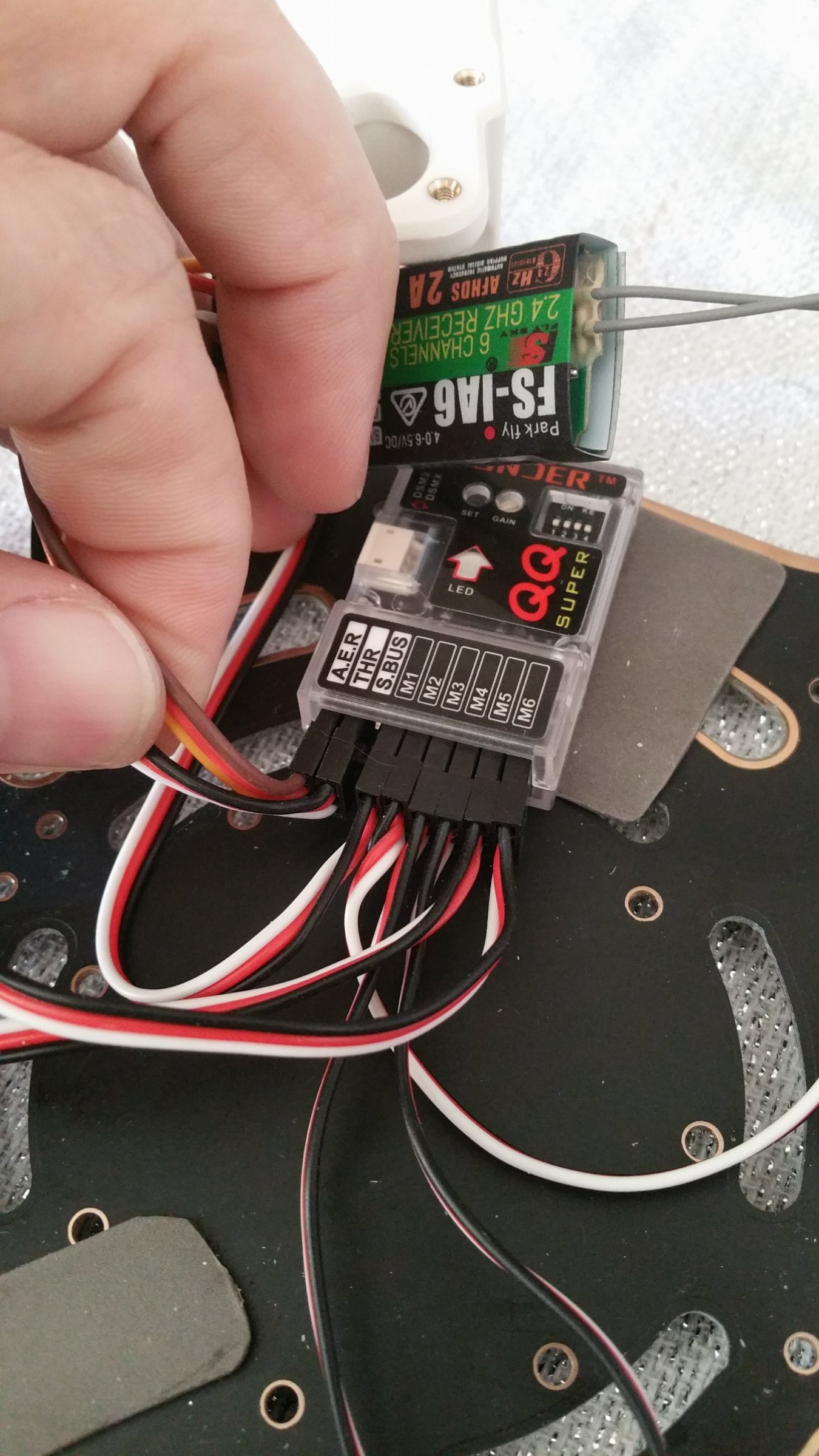

    I'm very new to drones. This is my first build.
    So what I have:
    Djf550 hex
    Fs-i6
    Fs-ia6
    Super qq controller
    30a esc
    Emax motors
    Symptoms:
    No reaction from motor. I get green light on super qq. All esc start up beep pause then beep again. Motors spin as they should
    Troubleshooting preformed:
    Tested each esc and motor connected to fs-ia6 only on ch3.
    Swapped out super QQ with another one
    Binded fs-ia6 with TX 3 times
    Replaced cables (TRU and A.E.R)
    TX settings are factory expect ch3 reversed.
    I still for the life of me can not get any reaction from the motors. What am I doing wrong? Is it settings in the TX? Is it my wiring? Please keep comments to the problem and not on quality of components. (This is a cheap first build)
    tdoshi9 likes this.
  3. RGJameson
    There is really no way to determine how you have it wired from your pic. Do you at least have the QQ's THR going to the i6's ch 3? Have you used the DIPs and set it to Standard?

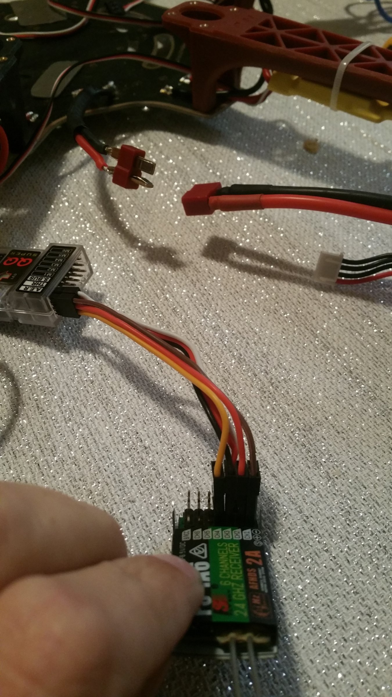

    Does this help?

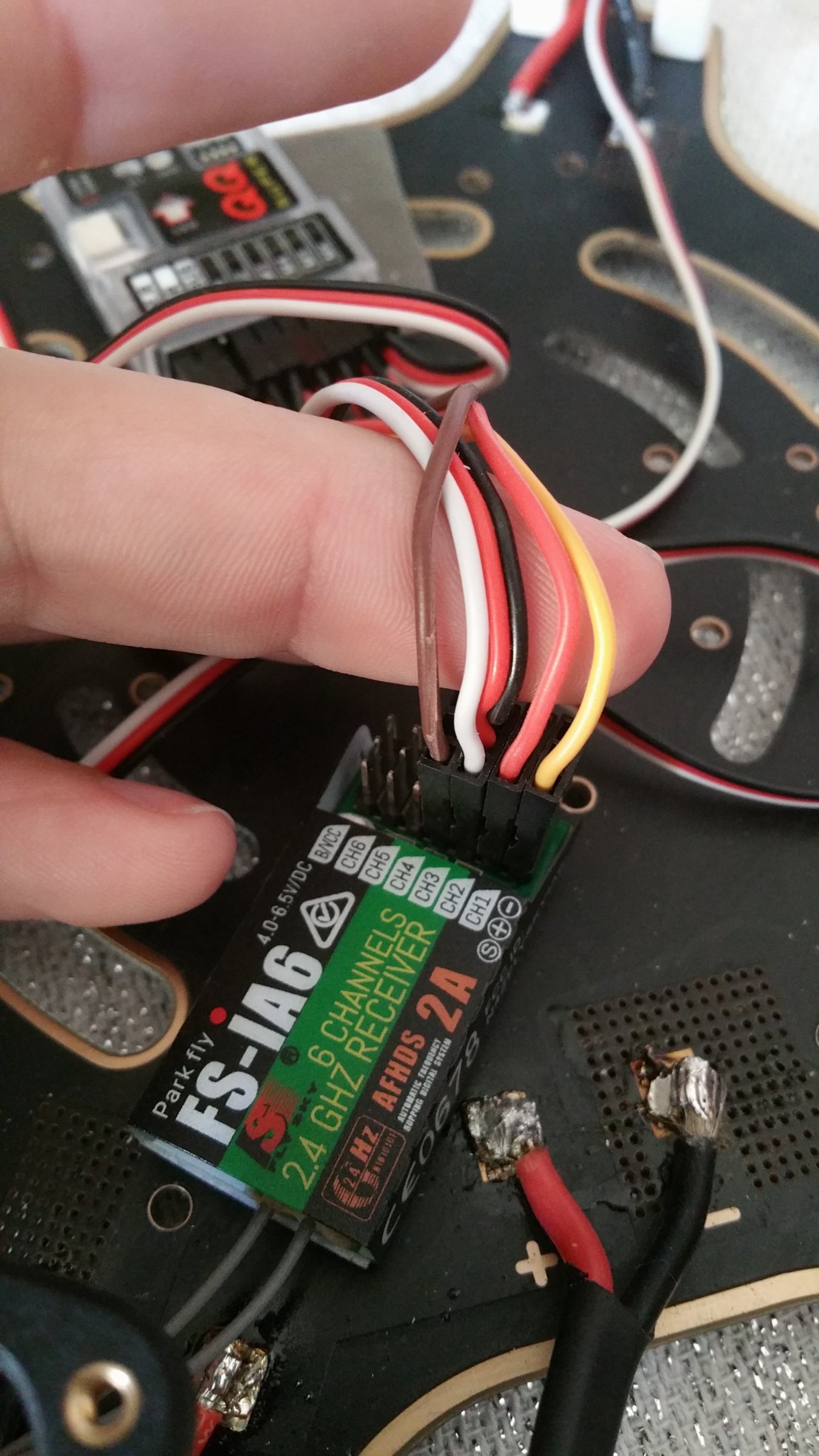

    tdoshi9 New Member
    And the controller

  7. RGJameson
    First you don't need to apologise about your FC.
    I have a hard time seeing it well but it here's a breakdown of the Flysky's channels.
    Double check that you are matching them up correctly with the FC.
    This guy shows it, there is no reason to strip out any ESCs wires though, just plug them in as is. Do note his dip switches settings at the end.
