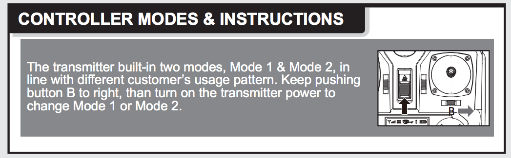

    Just unpacked & assembled my Syma X5C Quadcopter. Having trouble deciphering the poorly written Instruction Manuel and haven't been able to get to do more than flip upside down. Can anyone provide BETTER INSTRUCTIONS on fine tuning it? (And explain difference between (Mode 1 & Mode 2 ?)

    Mode 2 is what you should have in most parts of the world. That's the setup of the Transmitter - if the left stick is the throttle then you are Mode 2.
    It should have been in Mode 2 by default. If not, here is the diagram on how to make it that way.
    Make sure you put the quad on a very level surface when powering it up.

    Nope propellers are on correctly! I've placed the transmitter in Mode 2, Still can't get the damn thing to lift off. I've been able to adjust it to where it's pretty much level on the ground before increasing the throttle. Then it %^$#ing flips over!

    hmm... maybe Mode 1 is mode 2?
    Here is what a guy told me about mine
    "I know exactly what you did (cause I fell for it too at first [​IMG]. Syma's definition of "Mode 2" in the instruction book is actually Mode 1. DO NOT reset mode during startup. Syma's default "Mode 1" (the mode the controller defaults to at startup) is actually standard Mode 2. Again, just turn on the transmitter, and do not attempt to reset mode."
    So, try taking the batts out of the TX and then putting them back in and just turning it on and not setting to another mode? Who knows?
    I saw another person mention they were having trouble switching modes.....so that's probably the deal.
