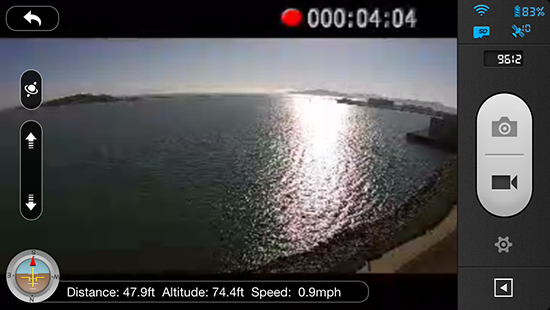

    Phantom- I think the vision would definitely do the job - but it's $1200.
    However, it may be that the cheaper Phantom Fc40 ($520 or so) would do the job.....they both have an app which works on your phone or tablet and I assume most of the parameters (altitude, heading) are on the screen display.
    screen shot from vision enclosed.....I'm not 100% positive that the FC 40 is the same, but it makes sense that it would be.
