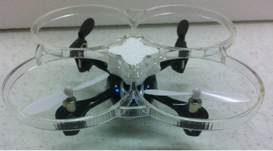

    Many have mentioned that the Hubsan Quads X4 is not a good first quadcopter due to the damage which is often done with hard crashes indoors or or cement or blacktop. I agree with that conclusion, BUT it's just possible that the very careful newbie could get the quad under control using something like this:
    http://cgi.ebay.com/ws/eBayISAPI.dll?ViewItem&item=261198703286
    I just tested these with my Hubsan Quads X4's. It worked fine on my newer (less than one hour on it) X4, and I was able to fly directly into walls, furniture and even plaster the X4 onto the ceiling! I didn't time how long the flight was, but the extra weight will surely cut your flight time - probably in 1/2.
    BUT, this is a trainer....not meant for use after you really learn how to fly.
    I had different results with my old worn X4. Obviously motors lose strength as they get some hours and crashes on them! The same can be said for batteries after many cycles and even the props. I was unable to get enough lift to easily fly the X4 around.
    However, again, this is a trainer so it is very likely that those who buy it would have a new X4 or Traxxas and not have that problem!
    The entire assembly weighs in at about 8 grams and, IMHO, is built heavier and thicker than need be. I experimented and took a couple grams off of one of them and it still worked fine. I have informed the dude who makes them that it would be nice to shave 2-3 grams off of them.
    Summary - if you have a newer X4 and want to learn how to fly it inside or outside on the blacktop or patio, this could help you get trained without destroying the quad. Even 5-10 flights with this will likely train you well enough to be able to take the training wheels off.

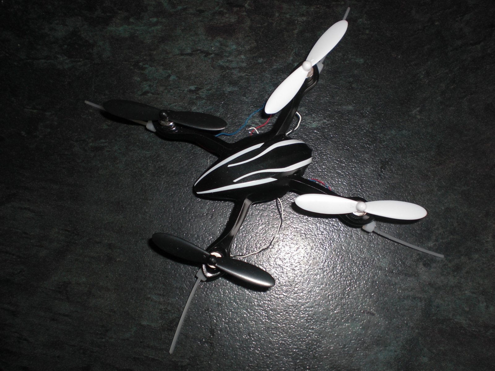

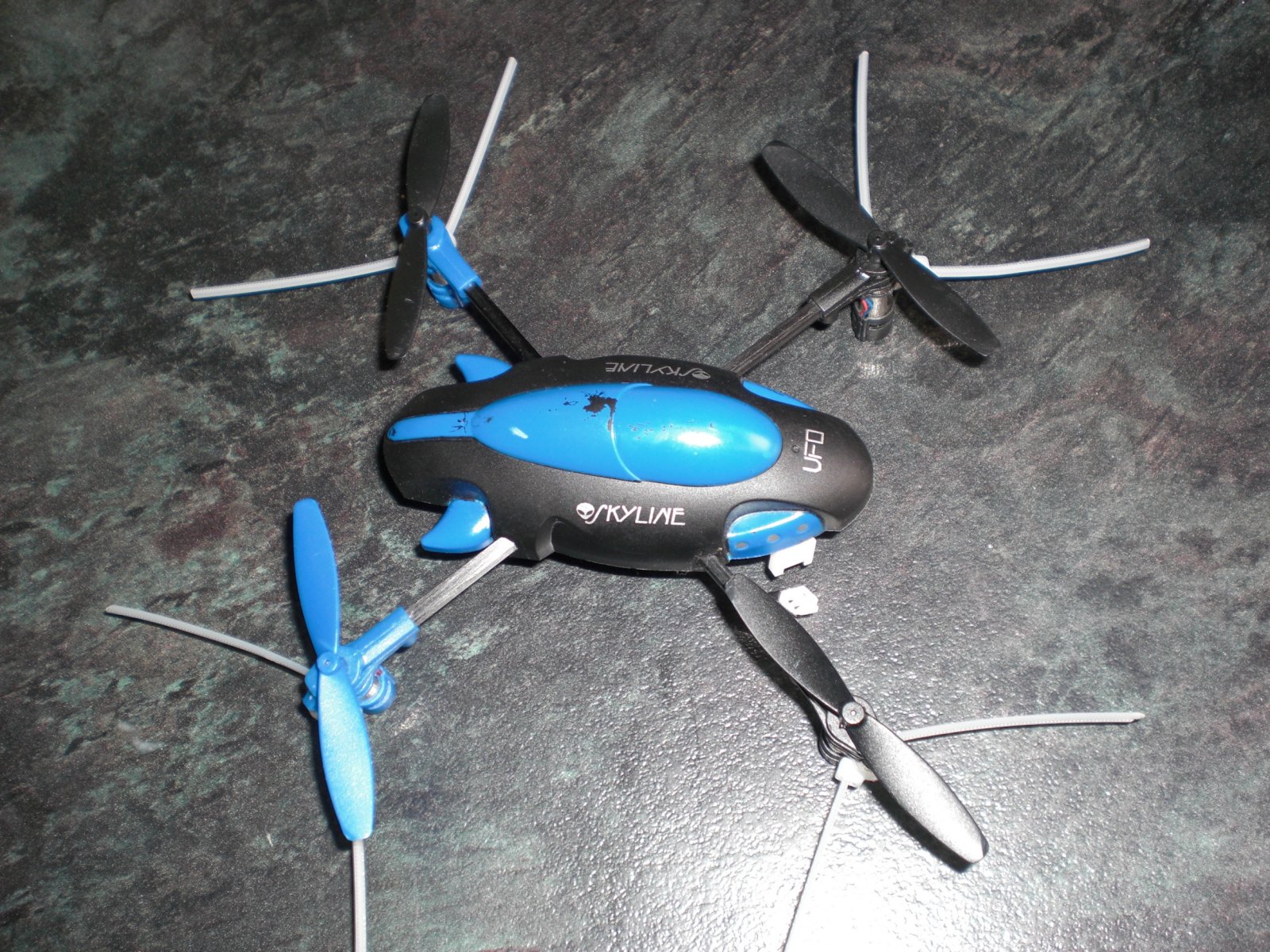

    I should have mentioned that you can use small cable ties (zip ties), tied into the motor cowling. They then act as 'fend offs' and stop you from clipping objects with the rotors.
    The second photo is of my YD-717 with a similar arrangement.
