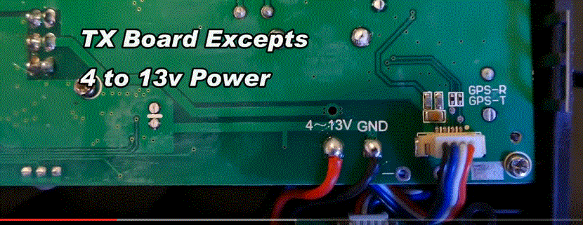

    Hi can anyone help me? I have just purchased the above drone and want to know what lipo battery I could use to lug straight into the jst port without wrecking the transmitter? If anyone knows that would be really helpful. Thks Mav
    Well take a look at the PCB inside the TX. If you see this.
    You can use a common 2S (7.4V, 8.4V when fully charged) LiPo.

    Thanks for your advice much appreciated.
