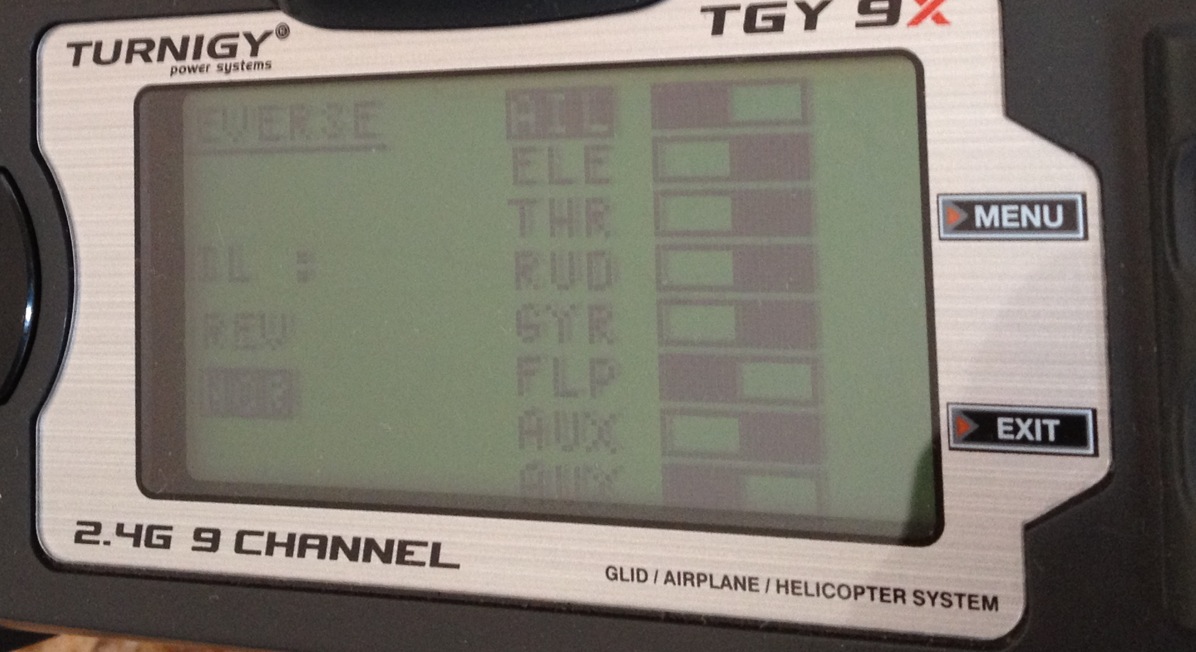

    Channel settings on stock 9X
    Mode 2 sticks
    Channel settings.......
    Mode 2
    AIL - normal
    ELE - Reverse
    THR - Reverse
    RUD - Reverse
    See enclosed...

  3. trevor lazarus
    trevor lazarus New Member
    Hey , Thanks alot for this killer tutorial, it was plain and simple , I ve been trying for months now to get this q bot in the air, with this simple tutorial I'm up in less than 5 mins, and thanks to the correct channel allocation, No full throttle on start up... again thank you so much for this !
