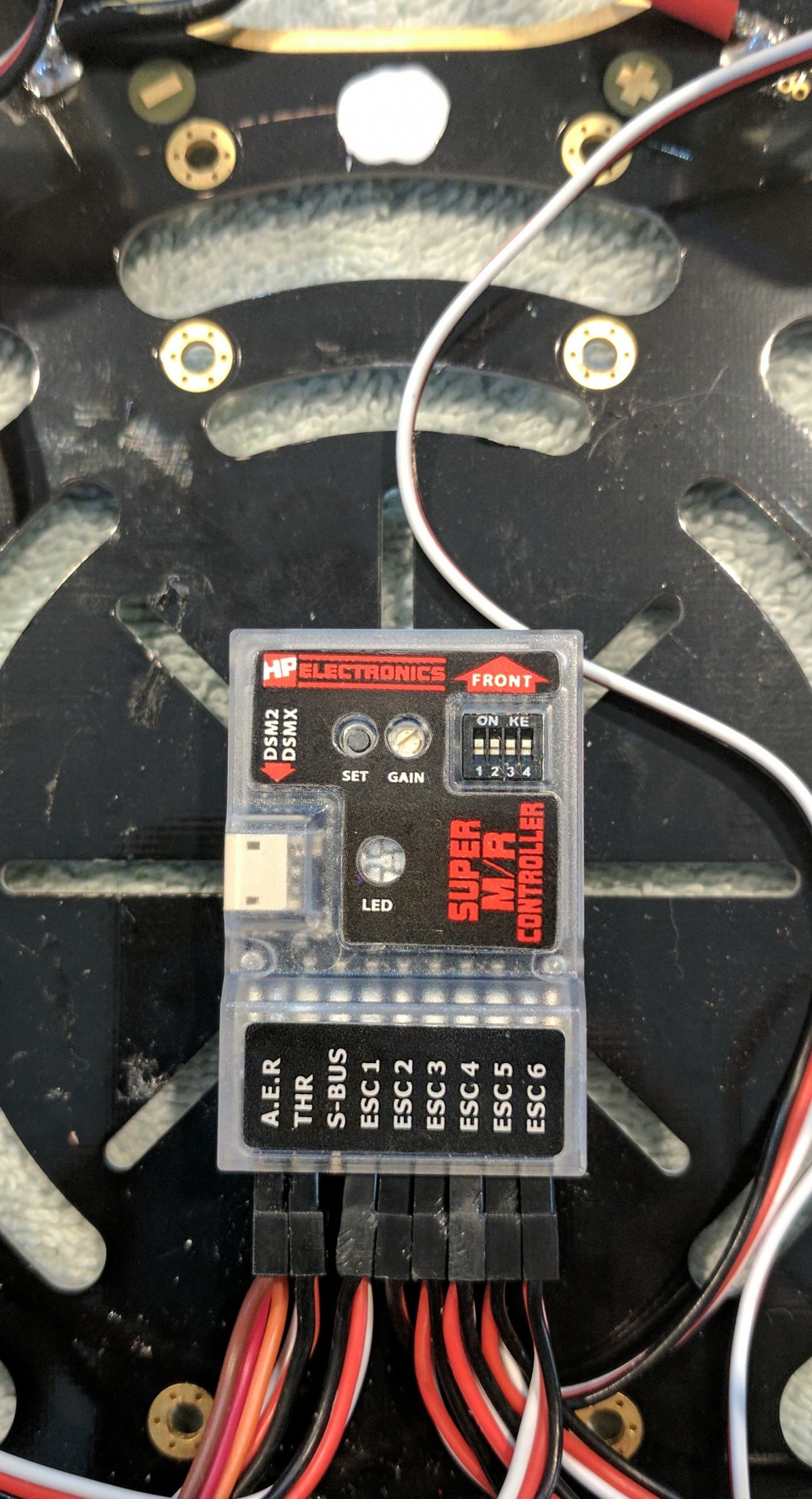

    • The fly board says ~ HP Electronics Super M/R Controller

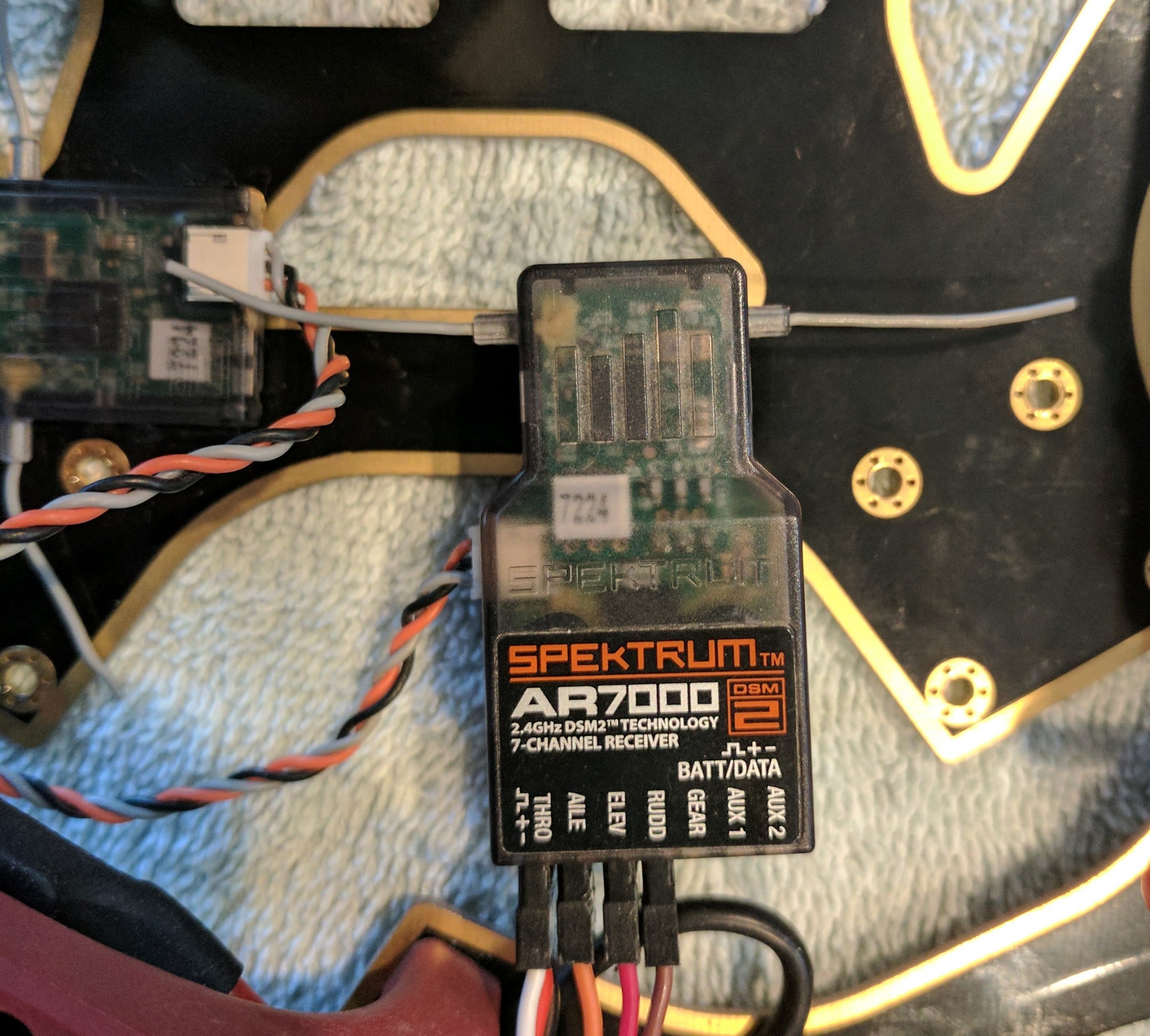

    I have the motors all turning (props removed) but at initial start several motors are spinning while others are not turning. When I apply throttle they will all start to spin up, but at different speeds. Which I know will make it not fly.
    ASK? ~
    How do I synchronize all motors to respond identically to the throttle input? It's as if they are all listening to the beat of their own drummer, (Pun Intended)
    I have attached pic of the Flyboard and my receiver, you can email me directly at Scott (AT) SkyK9 (.) Com or just reply to this post. I will be in your debt.
    Thanks ~ Scott (aka SkyK9)
    Try this to calibrate your ESCs. The flight controller is quite rudimentary BTW, with no options for various flight modes (self leveling, full manual and a hybrid of the 2), that are usually triggered on a fifth channel with a 3 way switch.
