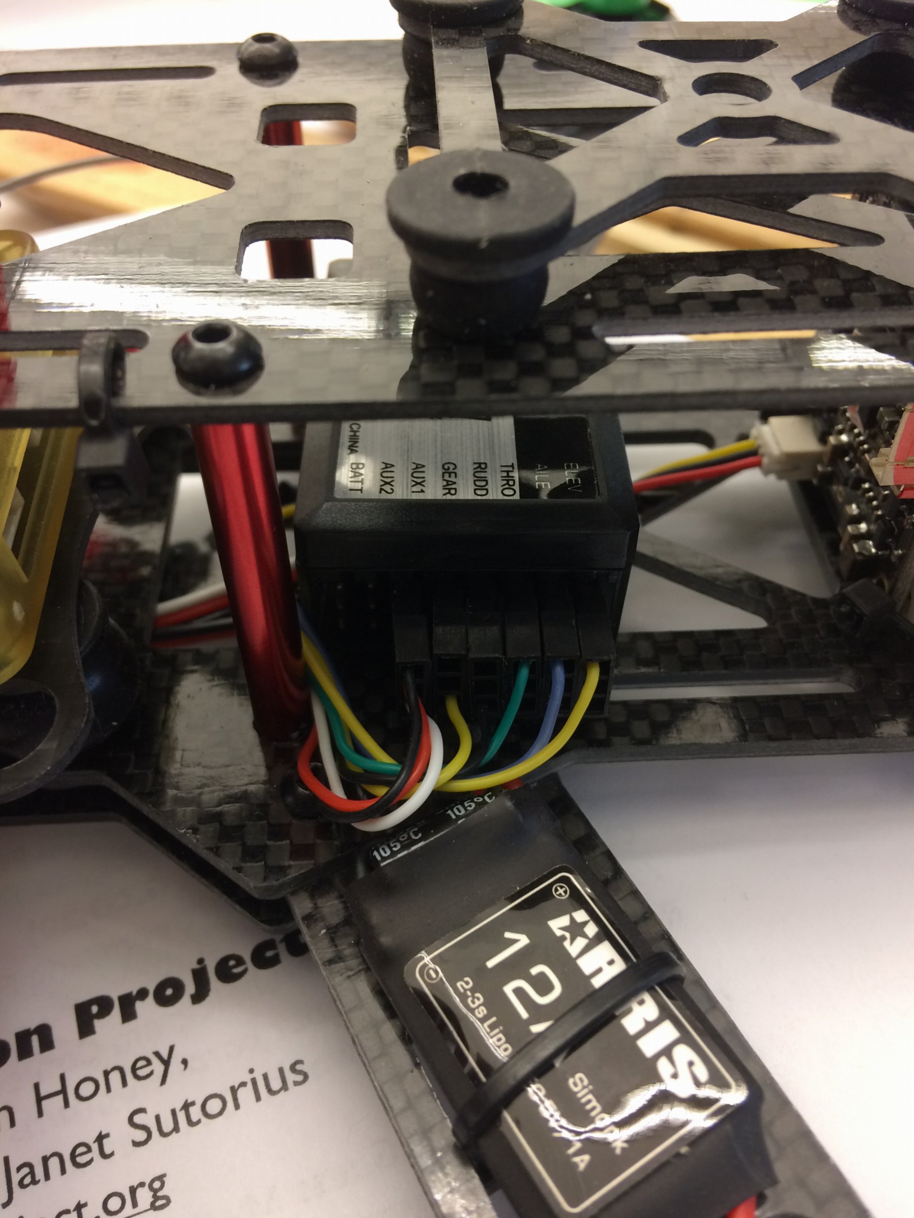

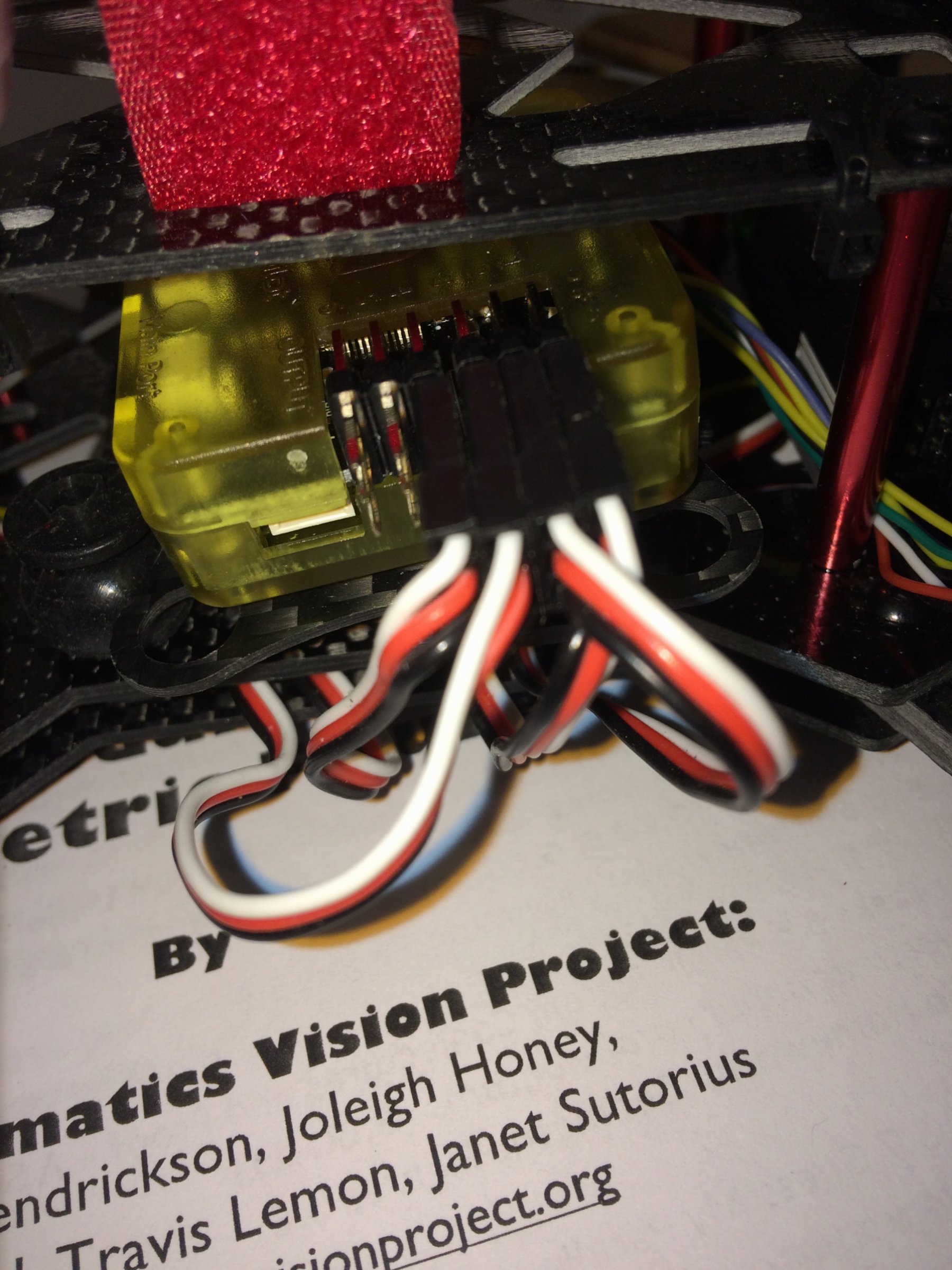

    Thank you for attempting to help me. The Receiver is a devention Devo AX702.4ghz the flight controller is open pilot i can not see a model number but it has a yellow clear cover. I have a strange option that the person that had this before me or one of the students moved a wire or two and one is in the wrong spot. [​IMG] [​IMG] here is what the current wires are set up as if the images do not show please let me know.

    Those wires do look wrong. The colors on the wiring harness can vary, but the lead with3 wires should be plugged into Throttle. You say OpenPilot, you have that installed on your computer I assume. When you plug in a USB cable is the software connecting?
