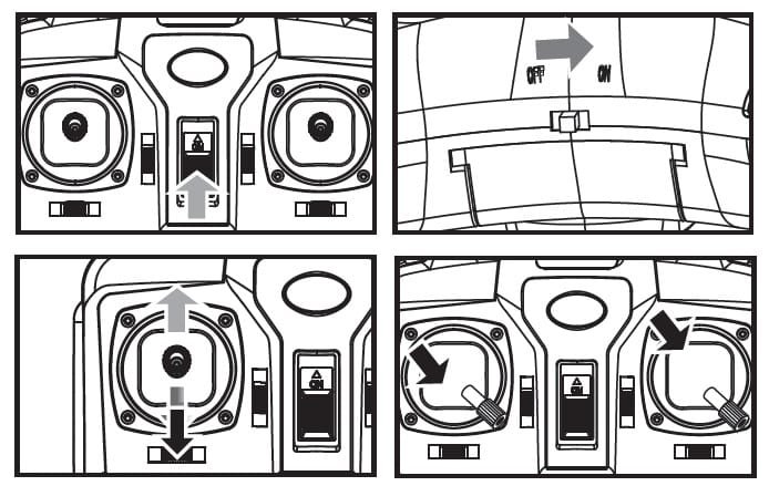

    Have you recalibrating it? First set the trims to center (see below).
    With the last step the lights will start flashing then stop when ready.
    Have you tried trimming (fine tuning)? First look in the LCD and center the 3 trims.
    Once up in the air push the trim buttons opposite to the direction it is drifting towards.

    Did you calibrate like in the first pic?????????
  8. technickel5
    technickel5 New Member
    I did. That was one of the first things I learned from Youtube was how to calibrate this drone. It seems to help some. I'm thinking that if I had more space, like outside instead of inside, I would finally get the hang of it. Problem is that it has been around 15-20 degrees all day today, and it was a bit windy as well. I live in Richmond, VA and that kind of temperature is very cold to me. I grew up in Minnesota, but have long, long ago lost my resistance to cold weather.

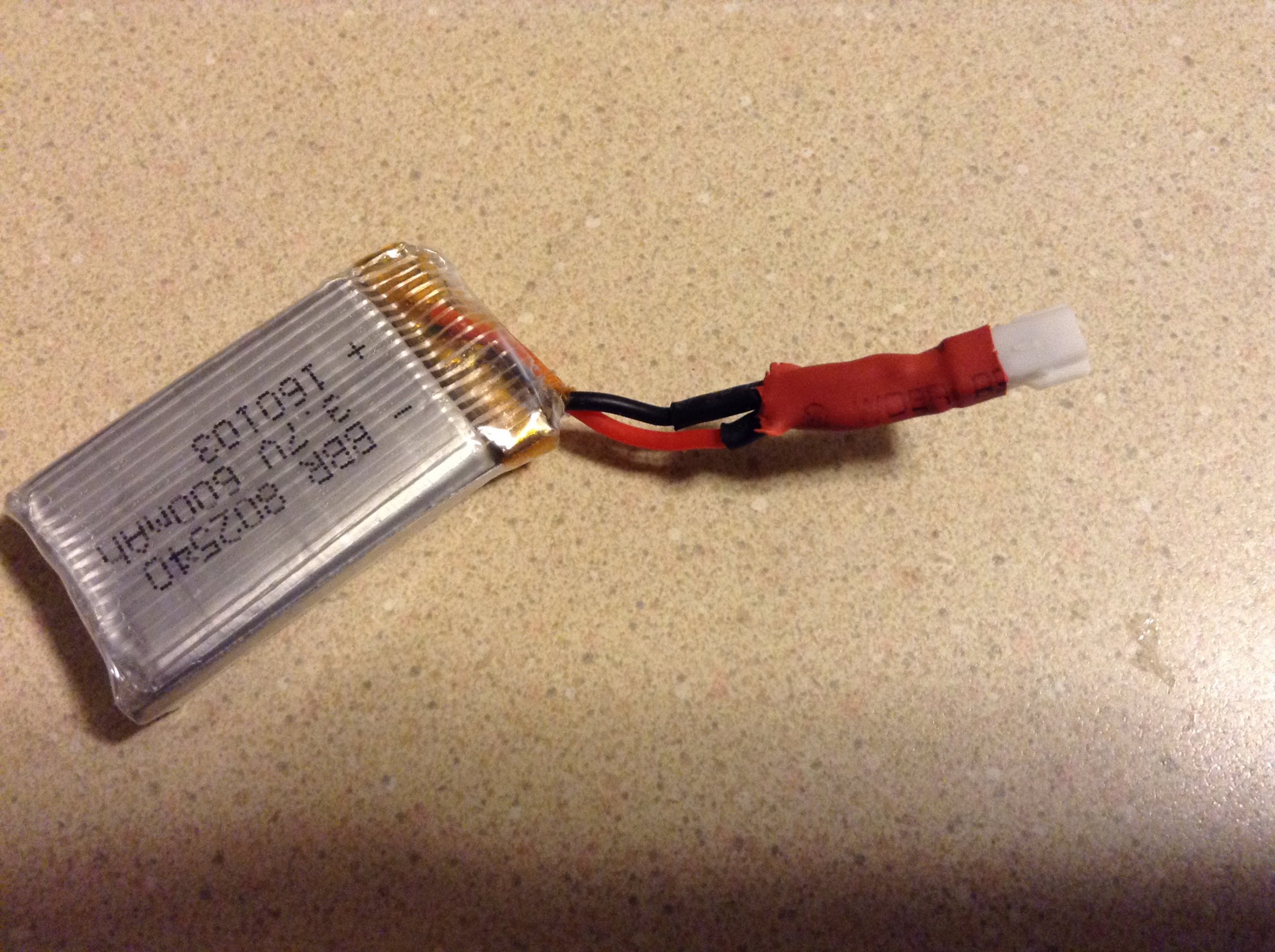

    Well, it lasted a week and two days. Much longer than I expected. Today the wires for the battery finally gave out. I tried to fix it and was able to get the inserts out of the plug and solder the wires to those inserts, and plug it back in. The lights came on and blinked, and when I turned on the transmitter, the lights flashed. I was able to calibrate it; but when I tried lift-off, nothing happened. The lights just kept blinking. I suspect some part of the teeny weeny connector failed to connect on the drone. Anyway, I don't think I'll try to recover it by buying a new battery. The whole thing is just too fragile to bother with anymore. My wife said it was just the cost of a good meal for both of us at a restaurant. She's very understanding. I did think of one trick that might have saved the battery and I'm posting a photo of it here. The idea is to use a short piece of shrink tubing to reinforce the wires that are on the connector and give more leverage to pull the wires when one needs to charge it. I'm quite surprised that all my yanking didn't tear it long ago. (I tried forceps, hemostats, tweezers, and long-nosed pliers; but none of those were satisfactory. And with my double-thumb hands, it's too tiny to pull without undue force on the wires.)
    For what it is worth, I'm posting my battery post-mortem picture here to show the reinforcing shrink tubing. Caution, if you do this, the shrink tubing cannot be very long. If it is, it is impossible to stuff the battery into the battery compartment. The compartment is way, way too small and forces you to contort the wires beyond any stress limit they have. 2016-02-18 19.41.40.jpg
