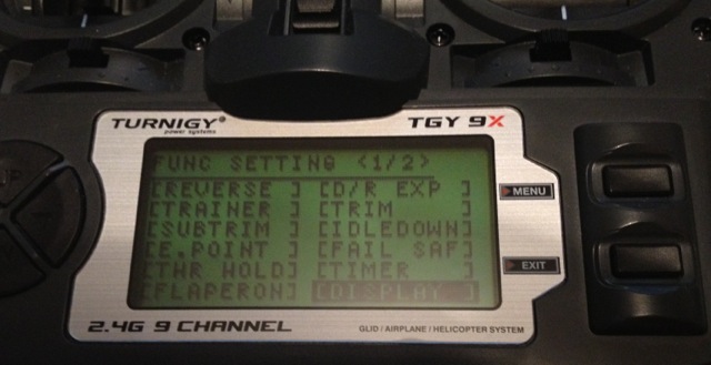

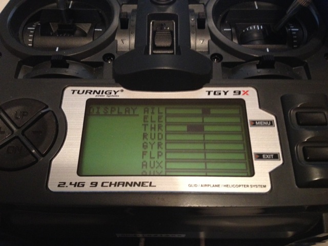

    It should have a similar function - here is a pic of the place on a 9X - the menu item is display and the other pic shows those bars moving when I move the sticks.
    OK, I looked at the DX manual and your function would be called "Monitor" instead of "Display".
