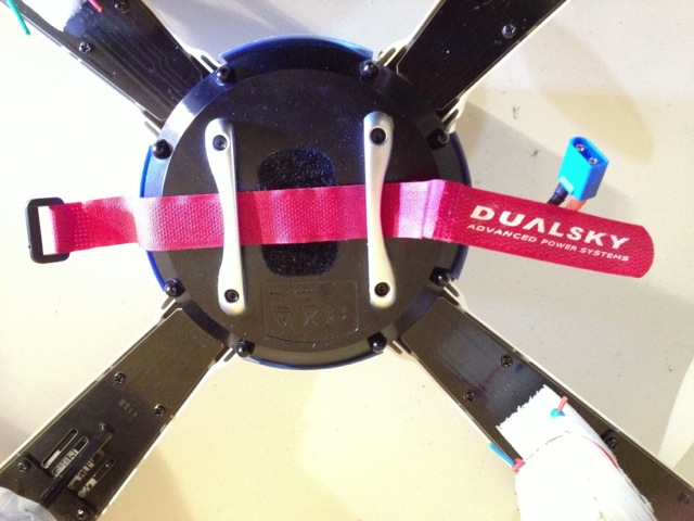

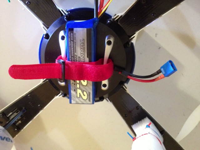

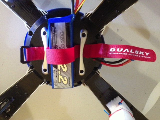

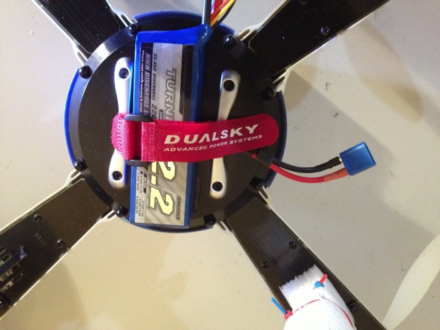

    Some people have mentioned shortcomings in the owners manual, including a lack of clarity on installing the battery. Here is a short video on the battery installation as well as some pictures. The installation is as simple as:
    1. Place velcro (included) on the based of the quadcopter between the two silver battery holder brackets.
    2. Place velcro (included) on the center of your battery and more velcro (not included) on other batteries you have for the quad.
    3. Thread the red battery strap underneath both battery holding brackets with the writing facing up- pull through until the buckle is against one bracket.
    4. Lift the center of the strap located between the brackets upwards - install the battery by matching up the velcro and pressing down, keeping it as centered as possible.
    5. Pull the strap end (with writing) over the battery, through the buckle and then back onto itself.

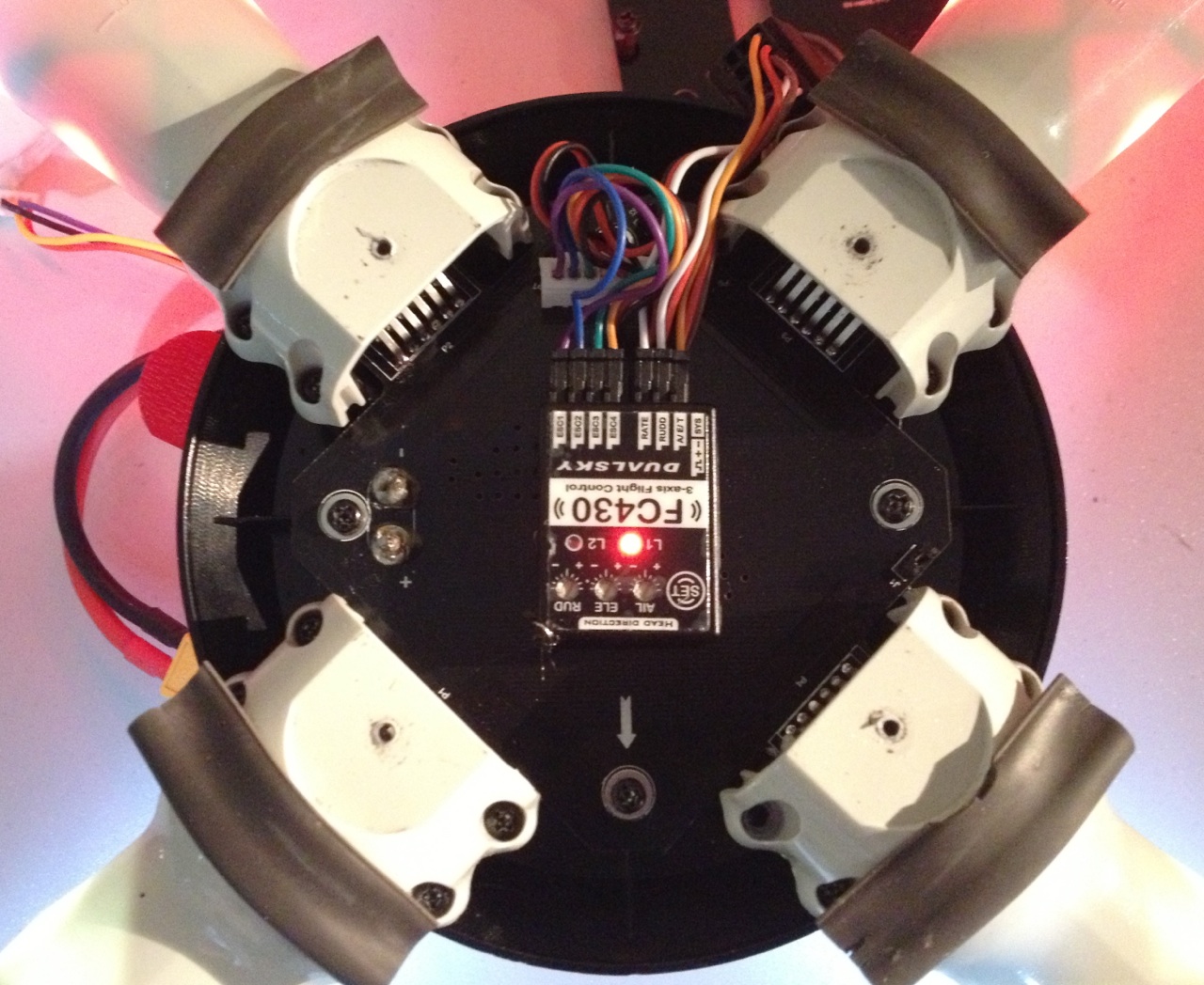

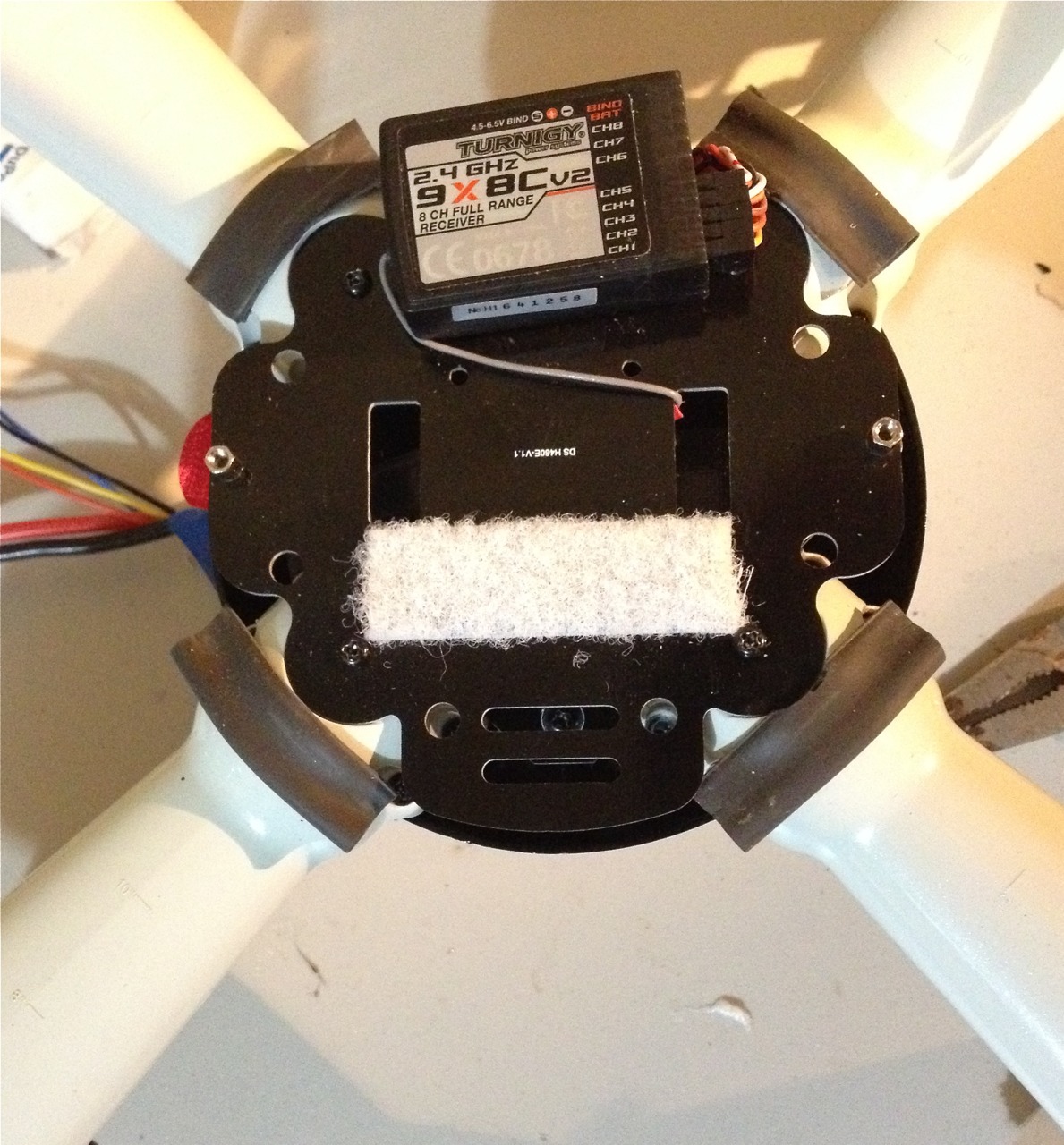

    I will be working more on the manual, however some users (and even the importer) have mentioned that, just to be sure, it may be a good idea to center the Flight Controller on the quadcopter - whereas the original information said it just had to point in the proper direction (forward).
    The pictures enclosed here show mine now - centered with the "head direction" end going the same as the arrow on the main circuit board. The receiver could still fit on that board (sideways - which is fine) or on the upper deck as I did. The velcro on the upper deck is for attaching one of my keychain cameras.
