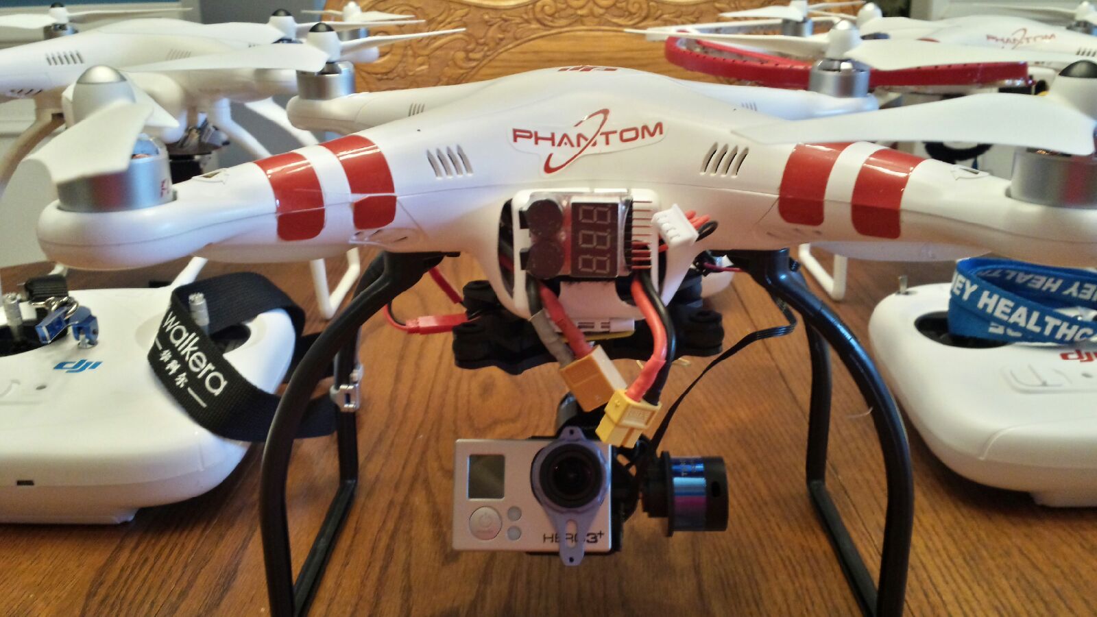

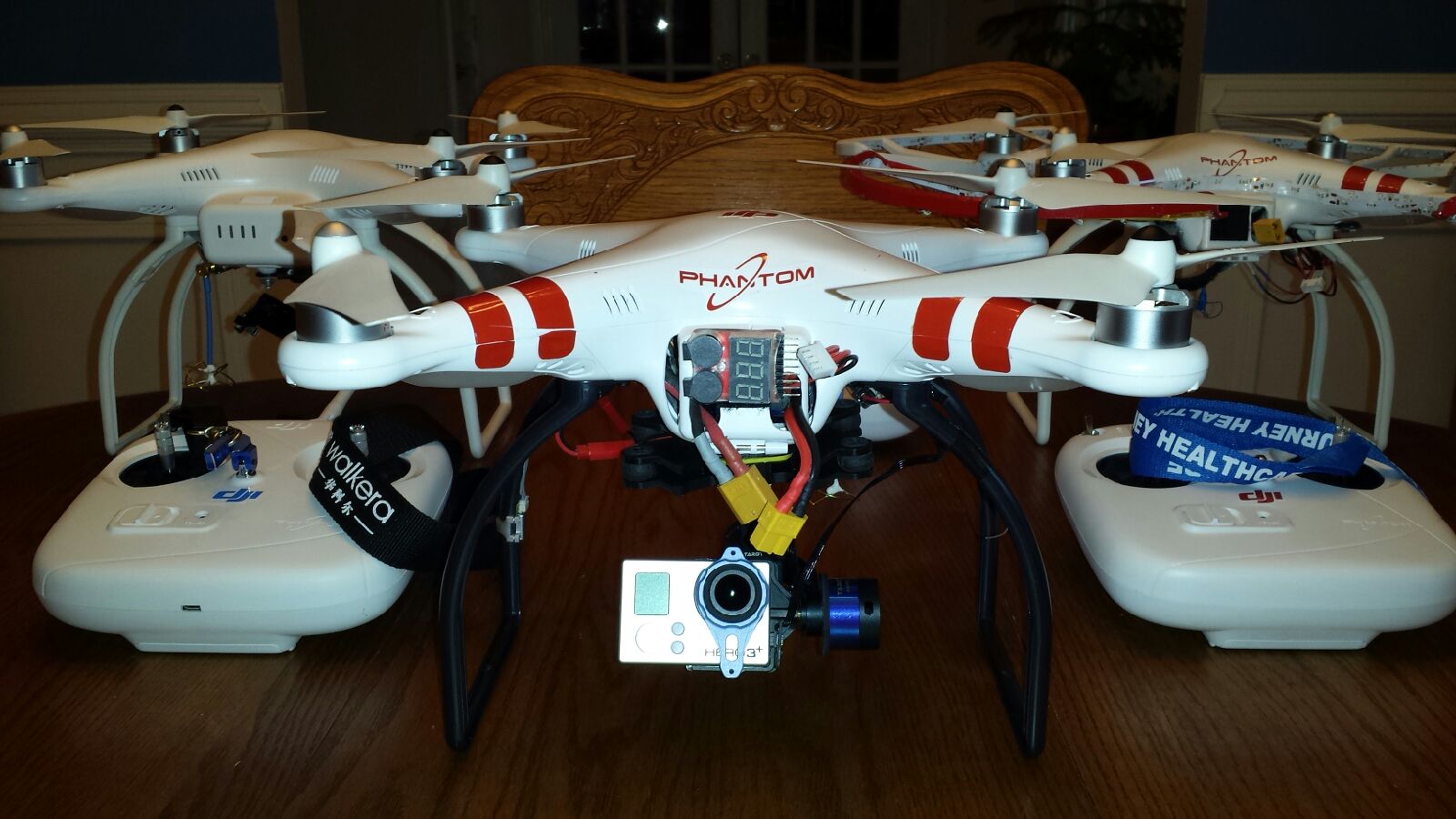

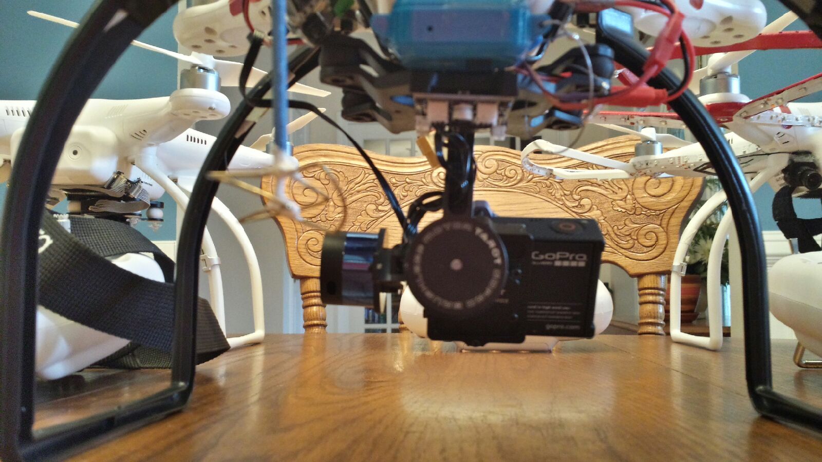

    Ok the weather was good tonight so while I was in the mood for testing I decided to give the 2800 Dinogy Lipo another test. I will put some photos up so you can see what it was tested on. Basically I took my Phantom 1 which had on the following equipment:
    Tarot Gimbal
    Fatshark 600mw Transmitter
    Gopro Hero 3+ Black
    Small Gps Tracker 1oz.
    Voltage Buzzer
    Dinogy 2800mAh Li-Po http://dinogylipos.com/3s-lipos/147-2800mah-3s-25c-dji
    It was flown at normal speeds so this is a real world test. The flight time was 11:02 I brought it back at 3.7v and stayed around my home. When the first red lights started flashing I brought it to about 2 feet over the ground. At 11:02 it landed on its own. I was very happy with this time, especially with all the extras that are on it.
    Hope this gives everyone a better idea of what times they would get.
