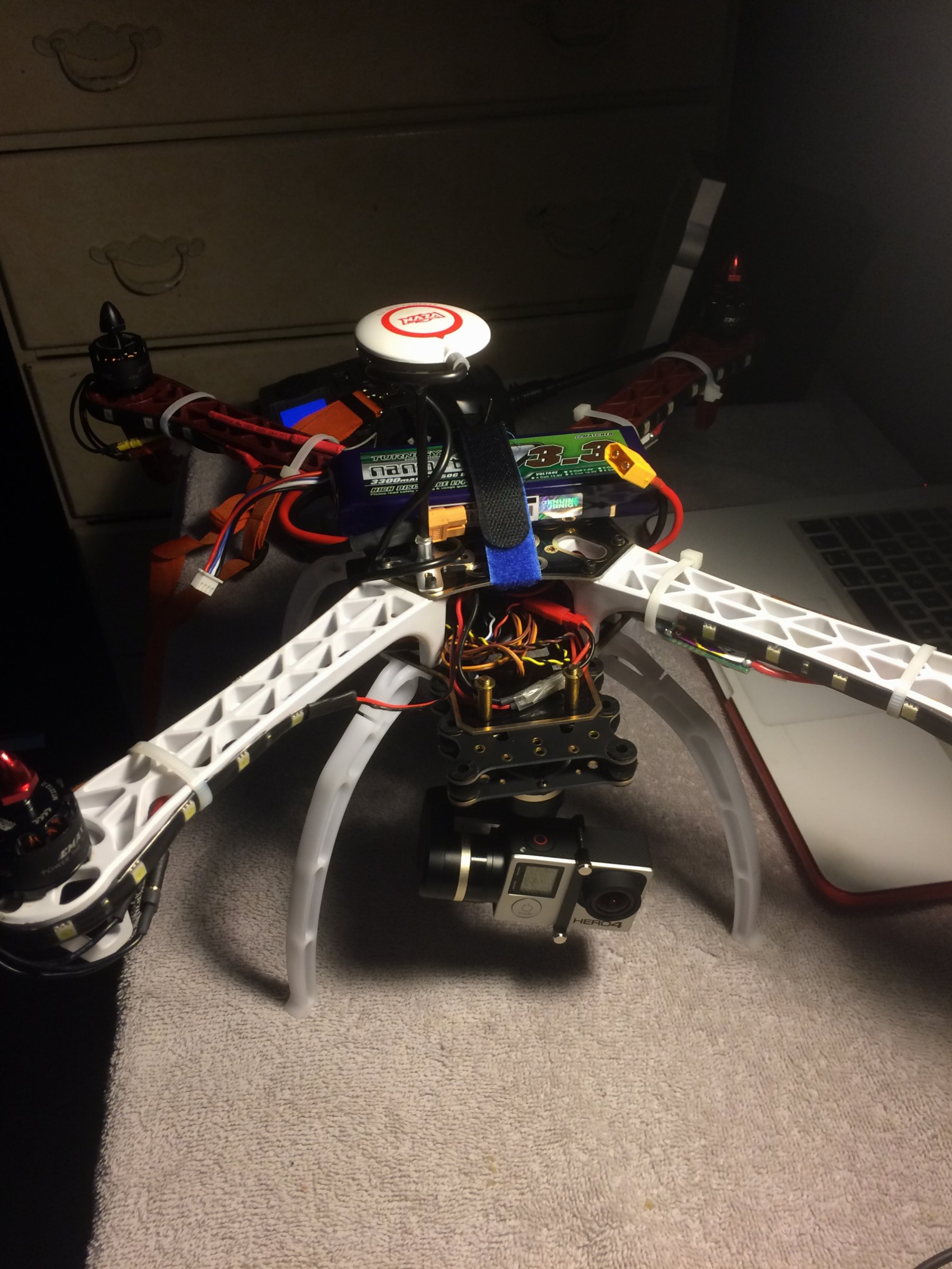

    I ended up just ditching the kk2 all together. the first one I bought ended up breaking(the screen would show no text). I decided to spend the money and get the dji naza m lite. I wanted a fail safe option since i was putting an expensive camera/gimbal setup. I still have to fine tune some settings but it works great. I really enjoy flying it. I want to build sometime of 250 Sized and get into FPV stuff. Im so glad i didn't just go out and get a phantom

    The naza is a great choice, that is definitely something you can take to new frames as you build new ones and the GPS will be rock solid. Kind of makes the APM look a little sheepish! RG was right though, the kk is a good board...generally. If you decide to get one again, maybe consider the one in the hard shell with a detached screen. The screen attached always made me nervous, seems too easy to damage if you decide to back-land. As for the phantom.....anyone can buy a RTF quad...the real skill comes into play when you build one yourself (along with a lot of pride). Just don't get discouraged there's a steep learning curve...I'm still playing around at the bottom of it!
