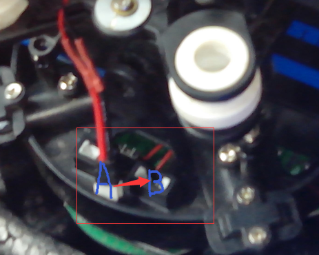

  6. lsn
    lsn New Member
    First test:
    The camera connected to a battery of independent 2S and the Connector plug it in the B .First time you connect the video plug only because the timer is put on the red tv and start counting away the plug and put it back in the B connector and video to make.
    Interructor ago of the video
    Second test:
    If I connect the A and B as in the photo and food with 3s battery and the other picture is seen tv interference and do not control or video or photo with the command.
    Can you provide some picture? And which battery i should use?
