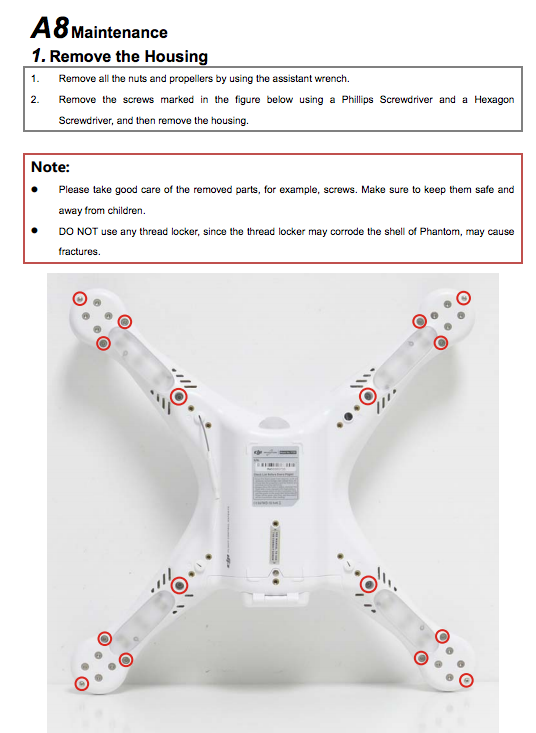

    2. Unfortunately, you have to take apart your Phantom to accomplish this task - but while it is apart, it's a great time to check all the connections, wires, etc. as part of your long term upkeep. The important thing about taking the Phantom apart is to place the screws in different containers and make certain the same ones go back into where they came from. So, using this diagram, remove the screws. However, you should first remove the props and prop guards (if installed) and disconnect the compass on the landing gear. Removal of the entire landing gear will make it easier to access some of the screws. Torx T8 is required for most screws, although the small screw at the end of each arm is a phillips (as is the landing gear).

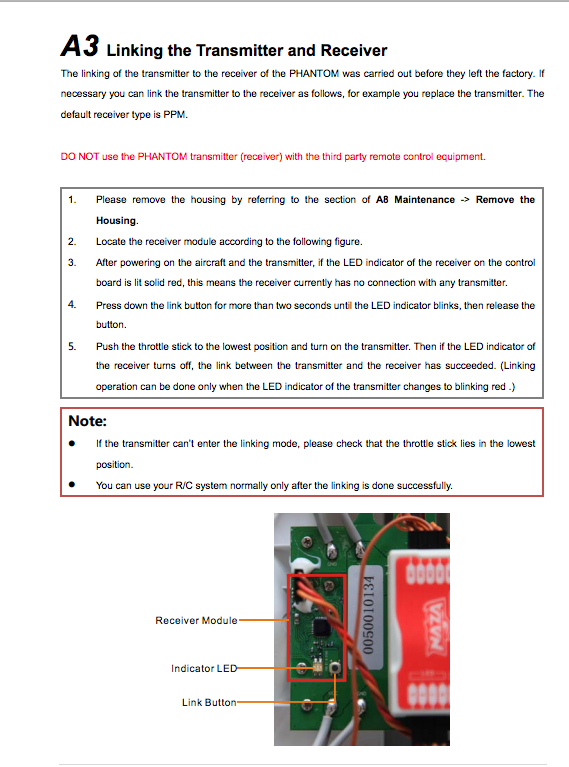

    3. Remove the Phantom top shell and set it aside - it will still be connected via the GPS and other wires, but there is enough play to move it out of the way. Locate the Receiver board - it is off to the side of the NAZA as shown in the picture below - and it contains a small LED.

    4. Place 4 AA batteries in the new SR6 Transmitter and turn it on. Then connect one of your Phantom batteries to the aircraft - leaving the battery outside the quadcopter (as you do when connecting the USB cable and doing updates and settings, etc.).
    At this point the LED on the Phantom receiver board should turn solid red, indicating that the Phantom is not bound to anything. Using a small screwdriver or pointer, press the small reset button which is located close to that LED on the receiver board - continue holding it down for a couple seconds - it should then start flashing, indicated that it is prepared for binding.
    5. It's at this point that some of the voodoo starts. DJI says it will bind if you turn the remote control (the SRG) off and then turn it on while holding the throttle downward. You will know it has bound if that light turns off. If yours is like mine, this may not work the first time. Continue with the "I'll get this no matter what" attitude and try the following:
    a. Cycle the power on the quad and on the new SR6
    b. If the quadcopter receiver LED is solid red, try pushing the reset button once again.
    3. While quadcopter is powered on, connect to your computer and the NAZA Assistant program and make certain that the setting for the Receiver type shows PPM. It may help to toggle it to another setting, hit return, and then toggle it back to PPM.
    After doing this dance for a short while, my Phantom magically bound to the new SR6 and I was able to comfirm it in the NAZA Assistant. Note that you should not change any other settings in the Assistant until you do the following.
