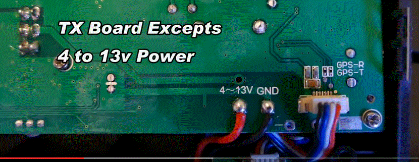

    Lipo to power the transmitter for a Hubsan Quads X4-501s. If I recall correctly the standard Hubsan Quads transmitter requires a voltage
    regulator to be installed, where as the advanced Hubsan Quads transmitter for the x4-501s has a regulator already installed.
  4. RGJameson
    Well with Hubsan Quads that's not a problem as the voltage it will accept is marked on the PCB.
